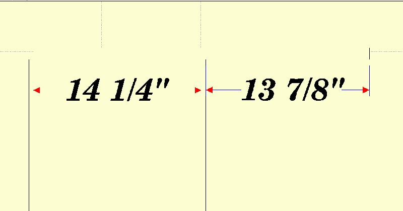

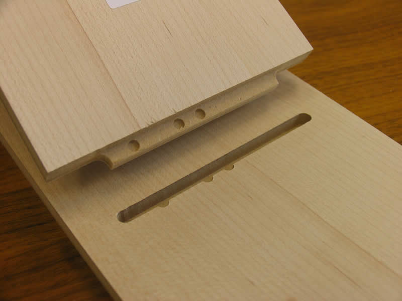

Gary Puckett wrote: AS for as the reference holes if the parts are together you know what the sides are and the bottom, stretchers, and the hangers why do you need the counter bored holes.
When you have a cabinet with a partition in it, does the tenon go to the left side or the right side of the part? On the Deck, is the tenon on the top or bottom? When you have a top stretcher and there is a partition and a small tenon at the top front of the partition that lines up in a dado on the underside of the stretcher. Which side is the front or back of the stretcher (if the partition is in the middle of the cabinet.) If you are using 3/4 material for example, that dado is going to be .375" to one side or the other of the center line and you can easily get that part turned around. When you have a shelf or mid deck, is the tenon up or down. It really make a difference when you go to put the face frame on the cabinet only to find one of your parts is inverted and proud of the mid rail.
Here is an example of a part with a dado in the middle of the part to except a center partition. You will notice the dado is offset .375" . Unless you inset tenons to indicate left and right and do all sorts of secret coded insets to dictate the correct orientation of the part. It can get confusing at times.
Well the picture did not come out correctly but you can get the idea.
blind dado.jpg (18.64 KiB) Viewed 33965 times

OK the way I construct a cabinet is my sides have a 3/4 x 1/4 deep rabbit on the top edge, a 3/4x 1/4 deep dado for the bottom, if there is a partition in the cabinet there is a 3/4 wide dado x 1/4 deep in the center that same dado is in the 2 strechers on top, the back has a 1/4 dado 1" in from back of the cabinet then a 3/4 x4 hanger is attached .
So we just have different methods of construction. If my jpeg would work I could show yu a picture, but I have VISTA :joker: and it don't work.
