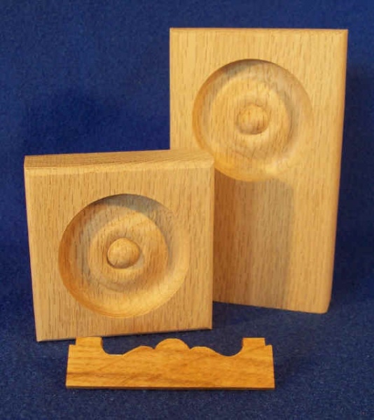

Before I try to make a tool to create a rosette, Is this possible, I mean how would you tell the tool to plunge into the face of the part?
Re: How would you
Post by Gary Puckett »
This is the rosette profile.

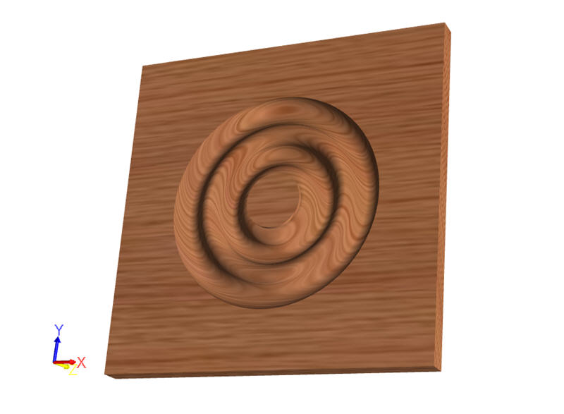

Here's a quick and dirty demo...

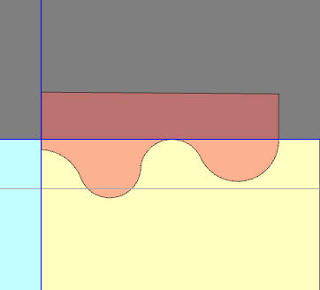

First, make your tool so it looks something like this:
Rosette Tool.jpg (10.03 KiB) Viewed 70779 times
Then draw a circle the size of the center "knob" on the center of the part in Contour Mode.
Then profile the circle in chain mode, setting the plunge so it gives the depth you want.
This one was very quick and crude...I didn't measure at all, just tossed it together.

Oh, make sure you design the tool so that the highest part of the center is the same as the other rings...not like mine where it left a flat top because it is lower than the others.
