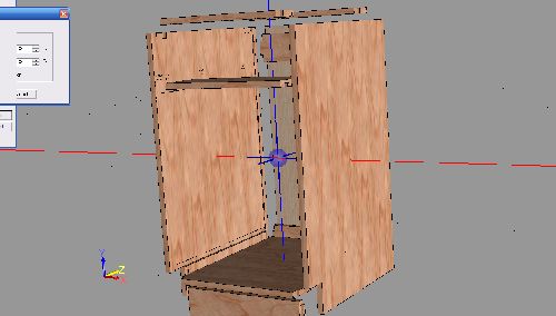

Are you wanting stop dadoes on the front like this?
I used a combination of blind and full dadoes with the tenons set at 1" on front and 0" on back.

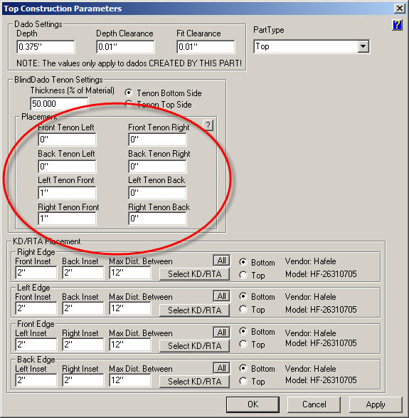

Here are the top settings I used. The deck settings are the same.
You can also change the tenon thickness (to 100%) or location (to top) to get a full stopped dado.

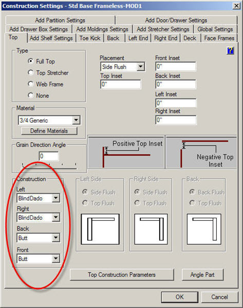

Dan, thanks for the reply. I understand the blind dado construction but I am asking about a full dado on frameless cabinets. I have a client who wants it and I am unsure why since we prefer blind dado every time. Nevertheless they want the deck and top full dado into the sides with a 1" set back, so the deck has a step out 1" back from the front of the cabinet and the dado is short of the cabinet face. Like a blind dado except instead of a 3/8 tenon, it is a 3/4 tenon. So if the deck is 3/4" thick, they want a 3/4" thick dado with a 1' set back from the front so the dado doesn't go out the front of the cabient. Clear as mud? I haven't found a way to do this in eCabs but there must be one?
Could I make it blind dado construction and make the dado setting to 100% and will it work?? Just wondering..... gotta go try it.

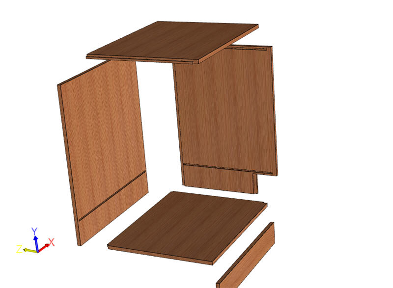

Eureka.... answered my own question! Like this.
