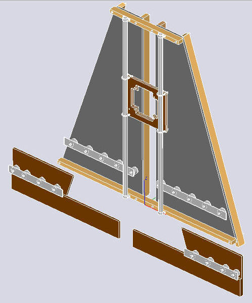

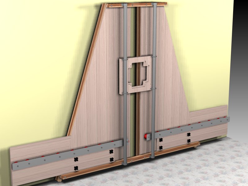

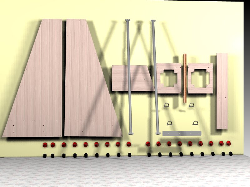

I had the plan I just got around to putting it in E-Cab
The CNC router should cut all the holes to. The hardware I made in a cad program

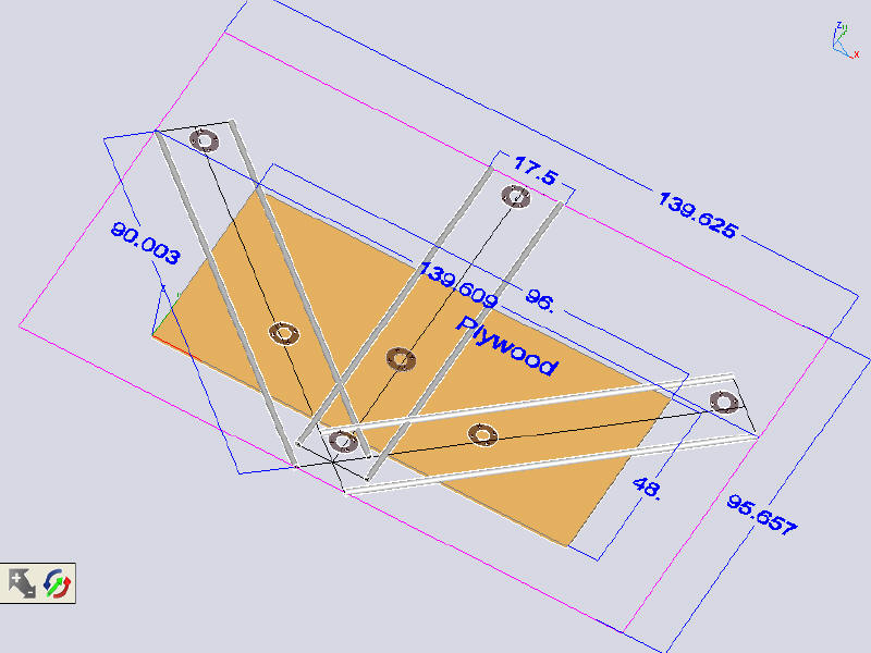

It will come apart and it will fit in my truck 12' long 8' wide 80 in's high

That's very cool George. I like the portability.

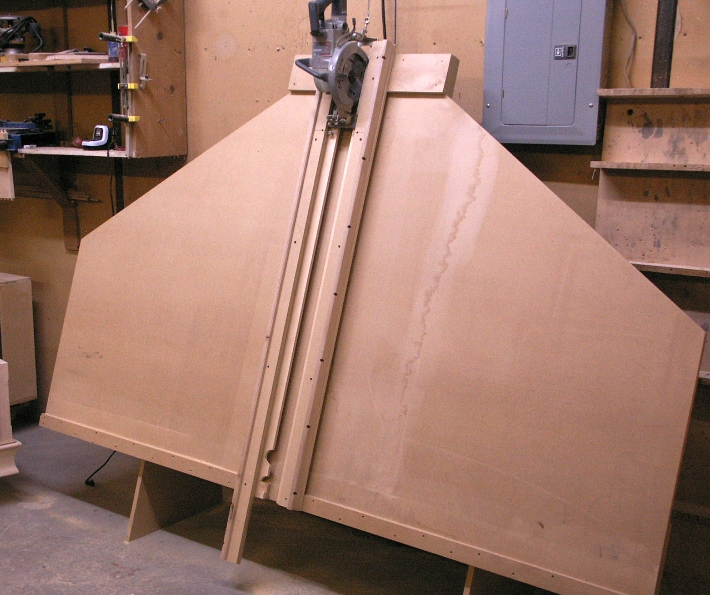

I am cutting out the 3 of them today

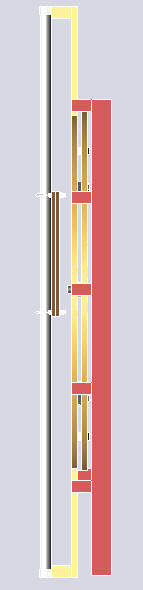

I am going to design a table one for saw and router it will be like a big mitter box. Be about 4' by 4' :?:

Your Panel Saw design looks great. A couple of years back I decided I needed one so I built this one. This would give everyone a good laugh but it has served me well. It is very high tech. The Skil worm drive is counter-balanced with a cinder block. Nothing but the best in my shop. :D
Post pictures when you get your router built.
