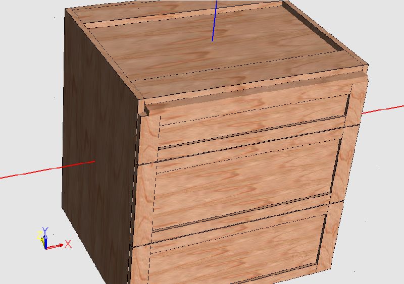

Alan,
Instead of adding a stretcher as a cutting board use 'display board.' Just add a display board the size of your cutting board. I am assuming it is cab. 23.
Cab. 23.jpg (69.4 KiB) Viewed 6638 times
Associate it to the cabinet and then you should be able to adjust drawer size. hth.
