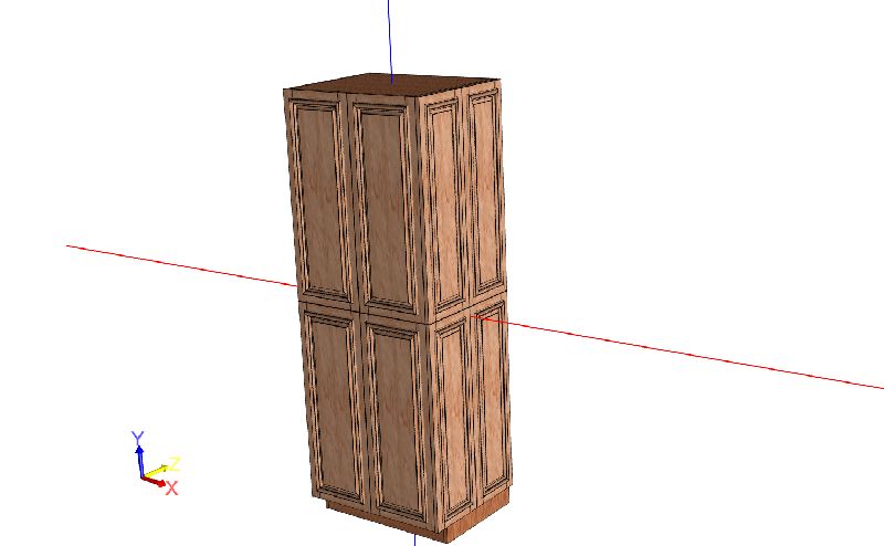

I'm trying to place a end panel on a pantry cabinet side. I know how to do it from custom layout, but I don't just want a single raise panel on the cabinet. I want to place four raise panels on this cabinet. I tried creating a cabinet the same size of the end panel that I need and placing double doors on it. When I remove all the parts but the doors my cabinet disappears. Can someone please help :wall:

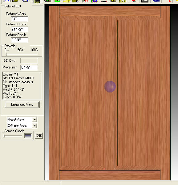

Re: end panels
It took me about 7 m to make this side panel just now

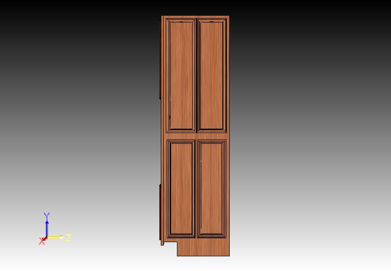

Re: end panels
Patrick, this is an assembly of two cabs. The first cab is a standard tall, the other is with all the parts removed except the back and fixed shelf. The back material is 1/32" thick called DNC Thin (Do Not Cut). The shelf is DNC. The cab depth is 1/16". The shelf is needed to give separation for the doors. This item is fully re-sizable, and shows correctly on the cut list.
John, we have been crying for that for a while now. :wink:
Tall w Panel.jpg (34.95 KiB) Viewed 27819 times

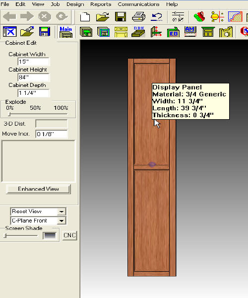

Here is my side panel
small 15 x 86

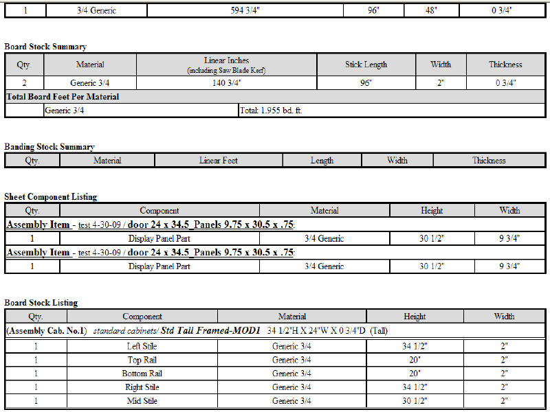

I make all my door in shop
Here is what I have been doing for my end Panels
Is there an easyer way to make them for the shop
End Panel_ 24 x 34.5_Panels 9.75 x 30.5 x .75.esa
(748.02 KiB) Downloaded 1656 times
End Panel 24 x 34.5 x .75_2-Panels.jpg (60.63 KiB) Viewed 27769 times
Cut List_End Panel_24 x 34.5 x .75.jpg (103.71 KiB) Viewed 27769 times
