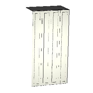

Got my lights sorted, now I would like to make my doors totaly from sheets stock using mdf for the stiles and rails and using a flat 9mm mdf panel. is this possible and would it be included in the costings,

Nope. The only way to use sheet stock for doors is with slab or MDF doors and those don't have a 5-piece option.
Re: Doors
Yup, if you look at the MDF as a board stock (Linear Measure, Board Foot Pricing). It just wont nest like sheet stock. Pull up a cut list for this cab, and you will see how it shows.
4 door tall.jpg (10.72 KiB) Viewed 5754 times
4 door tall.hsf
(136.02 KiB) Downloaded 554 times

Crikey, yea thats just what I want, but I'm blowed if I can figure out how you did it. I don't seem to have the Conestoga/Shaker style option in my door selection?? Where do I start?

I have done the same thing with MDF doors but in order to get a material quanity and pricing I had to create 2 board stock items one for the styles and rails and one for the panels. I figured the cubic inches in a sheet of 3/4 MDF and figured my costing per bd/ft that way won't nest but if I add 10% to the total bd ft needed it seems to work out close. I cut strips of material for the rails etc and it gives me the cut size for the panels.
