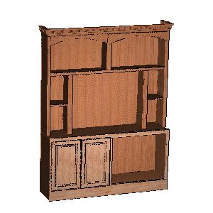

I am looking to construct this bookcase with mitered doors, but the provided mitered doors are only mitered in appearance. When I view the cut list, the top rail is the length of a style and rail constructed door. The style is the correct length but the rail is not. How do I setup a mitered door?

If your molding is 2 1/2" wide then set a Coping Depth of 2 1/2" in the Sizing Details for Cut List in the Door/Drawer Front Designer.
You can set up a material that is named Door molding for your Stile and Rail Board Stock.

Thank you very much, that corrected the doors.
