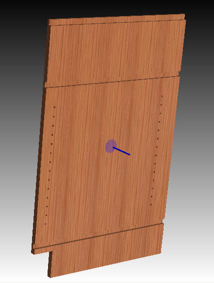

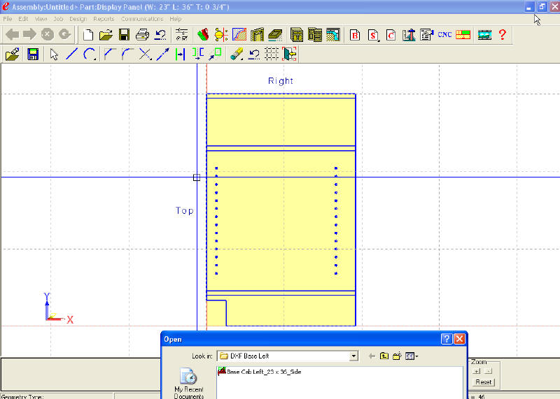

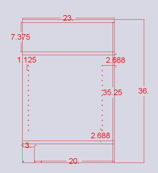

I am Big on making DXF for all my cabinets
Base Cab Left_23 x 36_Side.JPG (53.4 KiB) Viewed 4930 times
dxf 2.jpg (73.57 KiB) Viewed 4930 times
dxf 3.jpg (31.02 KiB) Viewed 4930 times
