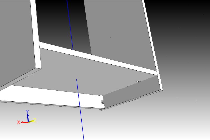

I do see the single cam as a potential spinning problem, I am thinking about combining our current setup and the cam setup. The current way is to place shelf pins in the holes and push the TK into place and the carpet holds it. So if I keep one of the holes for a shelf pin and a cam hole then this would take away the spinning problem.

John, with the cabinet you posted, just place a KD fastener on the top of the part going into the deck. Another thing you will want to make sure of, The KD Fastener that is on the deck and overlapping the stretcher, make sure you use FLUSH mount fasteners otherwise you will have a lip to contend with.
