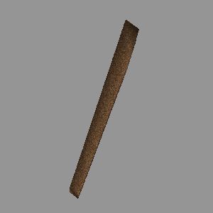

Here is a 2 sided tapered leg if you want to take the easy way out. It can be scaled and texture matched.
1182.hsf
(42.02 KiB) Downloaded 619 times

Thanks Kerry. I am not always going after the easy way out but this seemed ok. I am replacing legs on several chairs for a billiard room and this will help as I don't have much time to design. Now I can take the time to learn.
