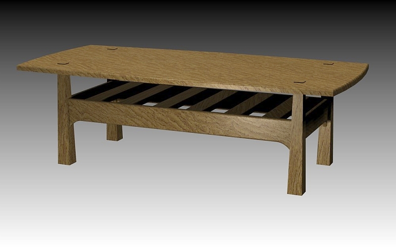

by Gary Puckett
Brad,
Don't get frustrated, hang in there you can do just about anything with this program. Just think on how you would build it and draw it the same way. Insted of buying the boards you create them.
This project was drawn that way.
