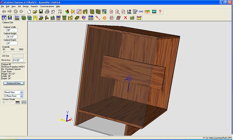

Up Down Stretcher - Front Back Orientation with insets

Not sure how you did that Kerry. Up Down stretcher goes between the top and the deck. Left Right stretcher goes between the sides. Front back stretcher needs two parallel parts like the back and toe kick, face frames don't count. The pic you posted has the stretcher between the back and the air. Can't replicate.

Glenn,
That's an up and down stretcher, applied between the top and the deck, with the front to back orientation (in construction settings) then adjusted via changing the insets to get it to be short from the top and the deck.

Josh is correct,
That is an up Down Stretcher with Front Back orientation between the deck and top the depth of the cabinet with the grain rotated 90 degrees.
You must then place the top of the stretcher where you want it using inset 1 and place a lock on that inset. Now when you must place an inset 2 that will size your stretcher properly and you can then lock that setting. You can then move the stretcher into place using the other insets. Lock as needed.

The grain direction had me fooled. And the fact that your stretcher material has to be as wide as the front to back dimension, which you need to calculate. Thanks.
