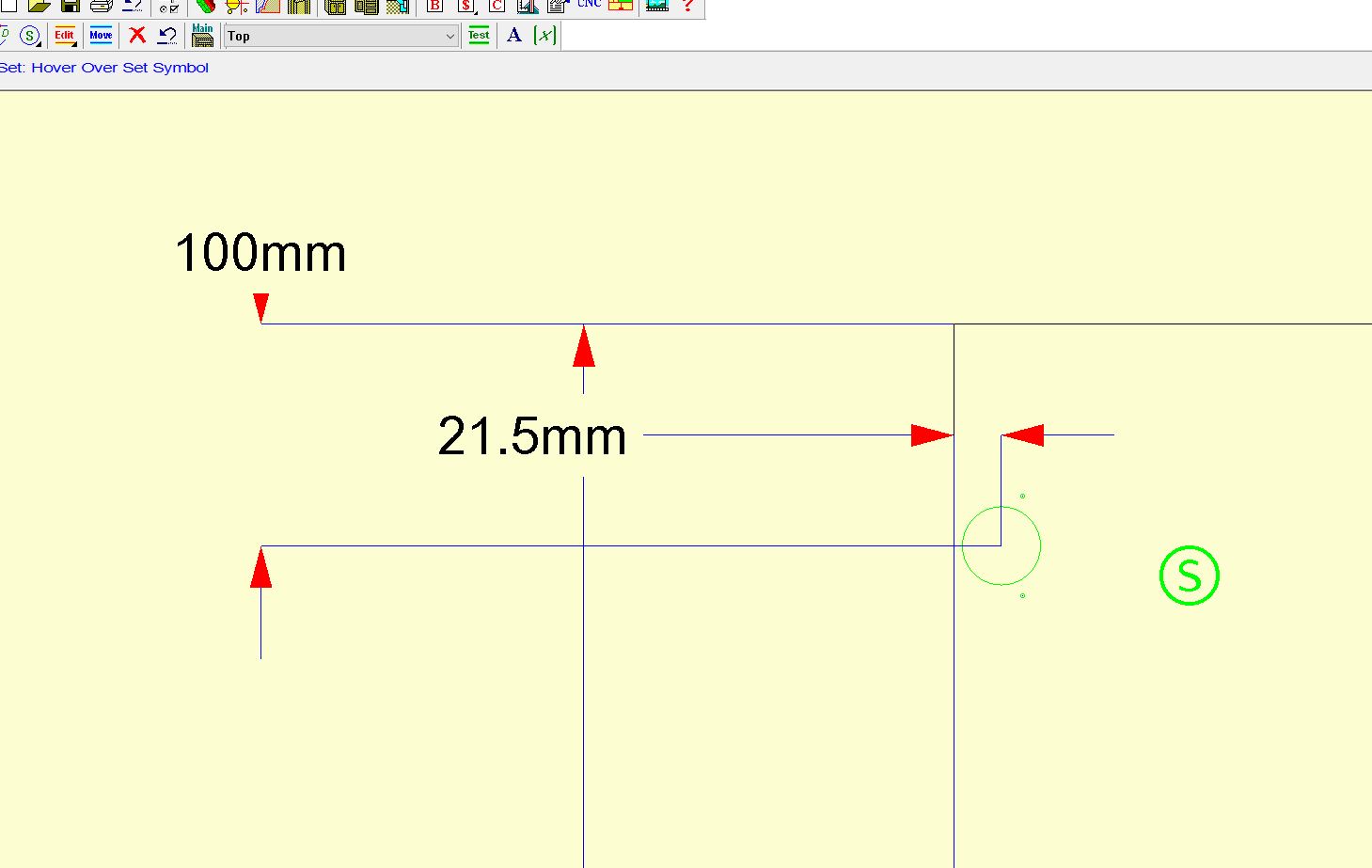

Once you create a set in the Constraints Manager, can you uncreate it to re-edit? I was trying to change diameters and don't think I can ungroup it?
Also can you copy and paste sets within the CM, I tried a few ways but I don't think so. Just looking for confirmation?

To undo a Set, choose the delete like you would to do a dimension and then select the set icon (the green S with the green circle on it). That will ungroup them from a set, you can make your changes and recreate the set.
