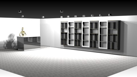

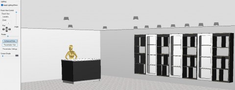

This a screen shot of enhanced view, pre-presentation view So when I render it doesn't display the rendered image it goes through the rendering process but it doesn't display like I remember it used to? It still looks like enhanced view.
But if I press Jpeg and save it saves the render to file.
This one is a saved render of the output jpeg but it didn't display. Thanks

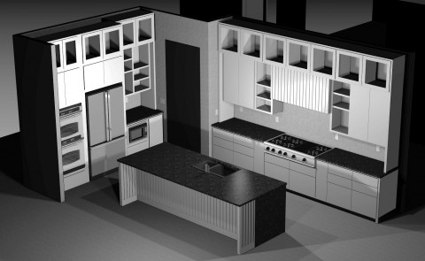

Do you not get any image when you do a Presentation View?
It seems that in the past, the Preview Render created a smaller, lower quality image that rendered much quicker. Now there is a little difference in the quality, and render times seem about the same as the Full Render.
For my rendered presentation views, I just do the Full Render and use the Windows Snip Tool to grab the part of the images that I want to use and paste them into IrfanView or Paint Shop Pro to finish them off. (I normally just sharpen the image and convert them to greyscale, so clients aren't distracted by the colors in the image.)

Thats a very nice job Kerry.
The Calculations take place but the image stays the same as enhanced view and the shadows and lighting effects don't show on the screen. (so I don't see a preview of the render)
But if I use the save Jpeg button after it does its calculations, the image is saved with all the shadows and lighting effects.

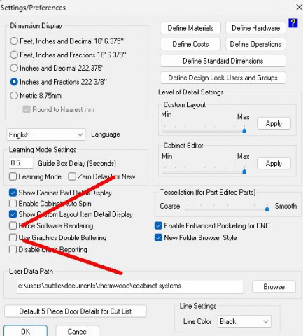

Just for fun, try checking these two boxes in Settings/Preferences (maybe one at a time) and see if anything happens.
- Posts: 539
- Location: Sydney Aust
Re: Is rendering playing up for anyone else?
Hi Kerry.
It was good fun.
That worked. Thanks for that.

I just switched to force software rendering and it render on screen again. ¿does that mean it is not using the GPU anymore?
