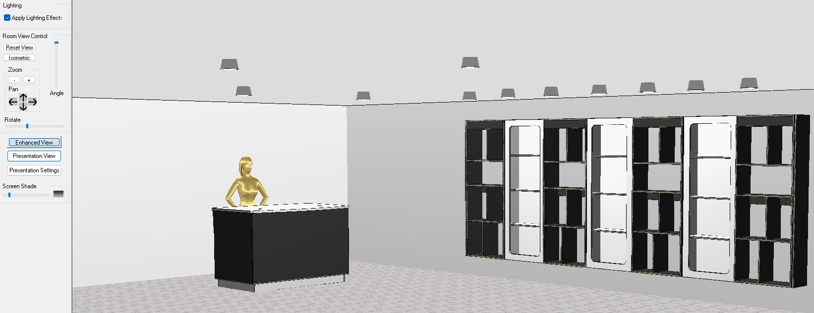

This a screen shot of enhanced view, pre-presentation view

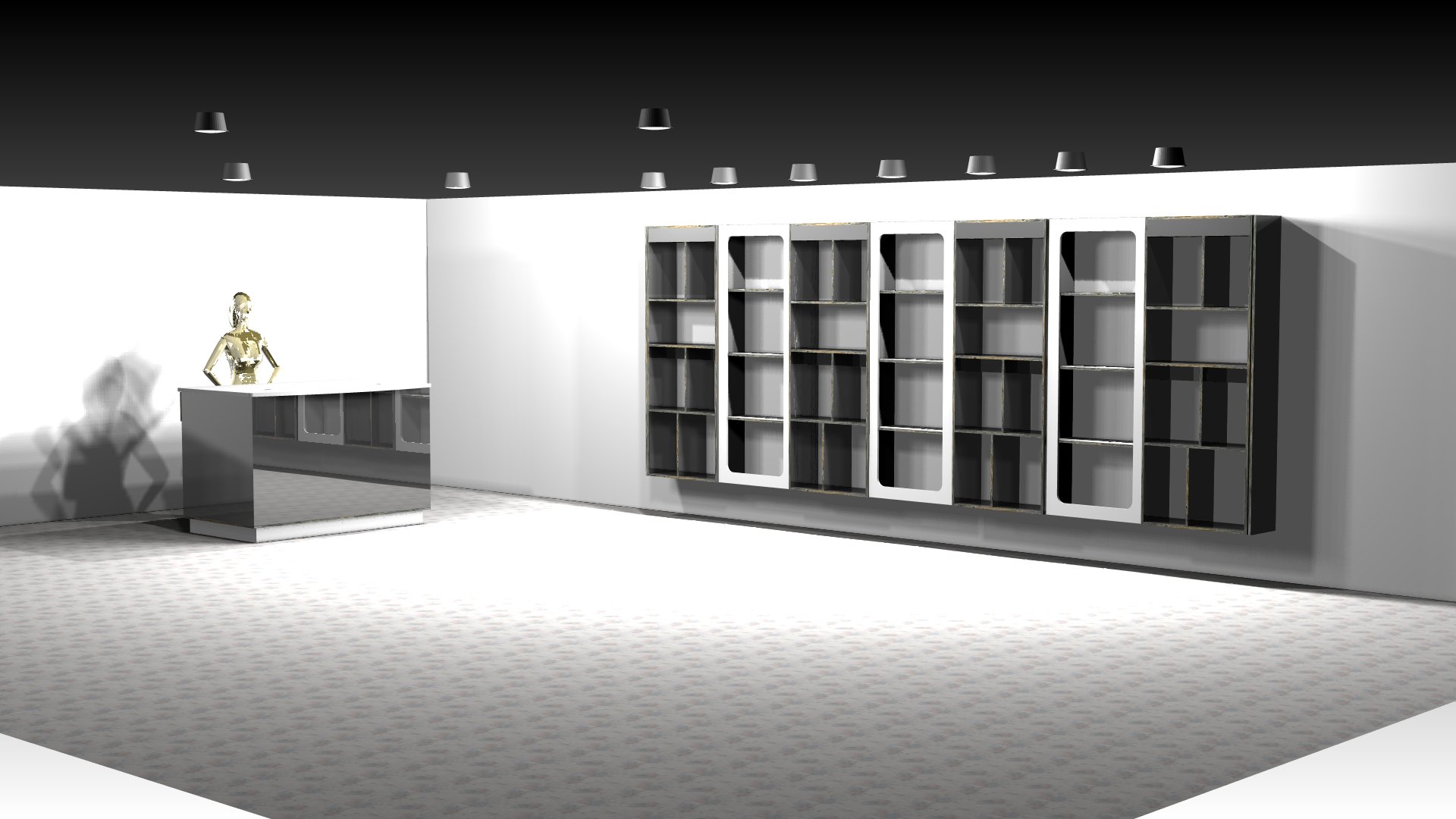

So when I render it doesn't display the rendered image it goes through the rendering process but it doesn't display like I remember it used to? It still looks like enhanced view.
But if I press Jpeg and save it saves the render to file.
This one is a saved render of the output jpeg but it didn't display.

Double check in Presentation Settings you have it set for Full Render. Even with mine set to Preview Render I still get a decent render, but I'm working with simple stuff to verify operations.
Re: Is rendering playing up for anyone else?
Mark,
A couple of things you might look at.
First, you have a lot of light in that room for a render. (look at the flare on your floor)
I would probably just use two, maybe three fixtures for that room and turn the intensity down. I rarely use the down lights either, I have the best luck with the 4 light chandelier. You can hide the fixtures when you do your render. (place 2 at ceiling height and one halfway between floor and ceiling.
Make sure you have added shine to all of your textures. I use a setting of 2 for floors and walls, 3 for boxes, 4 for things I want to highlight, (moldings, doors) and 5 for countertops.
I'll add a third thing. In presentation settings I have better results using scan line rather than ray trace.
Less light is always better. If a light starts to wash out your textures, turn it down. Fix the final render in Photoshop or something similar.

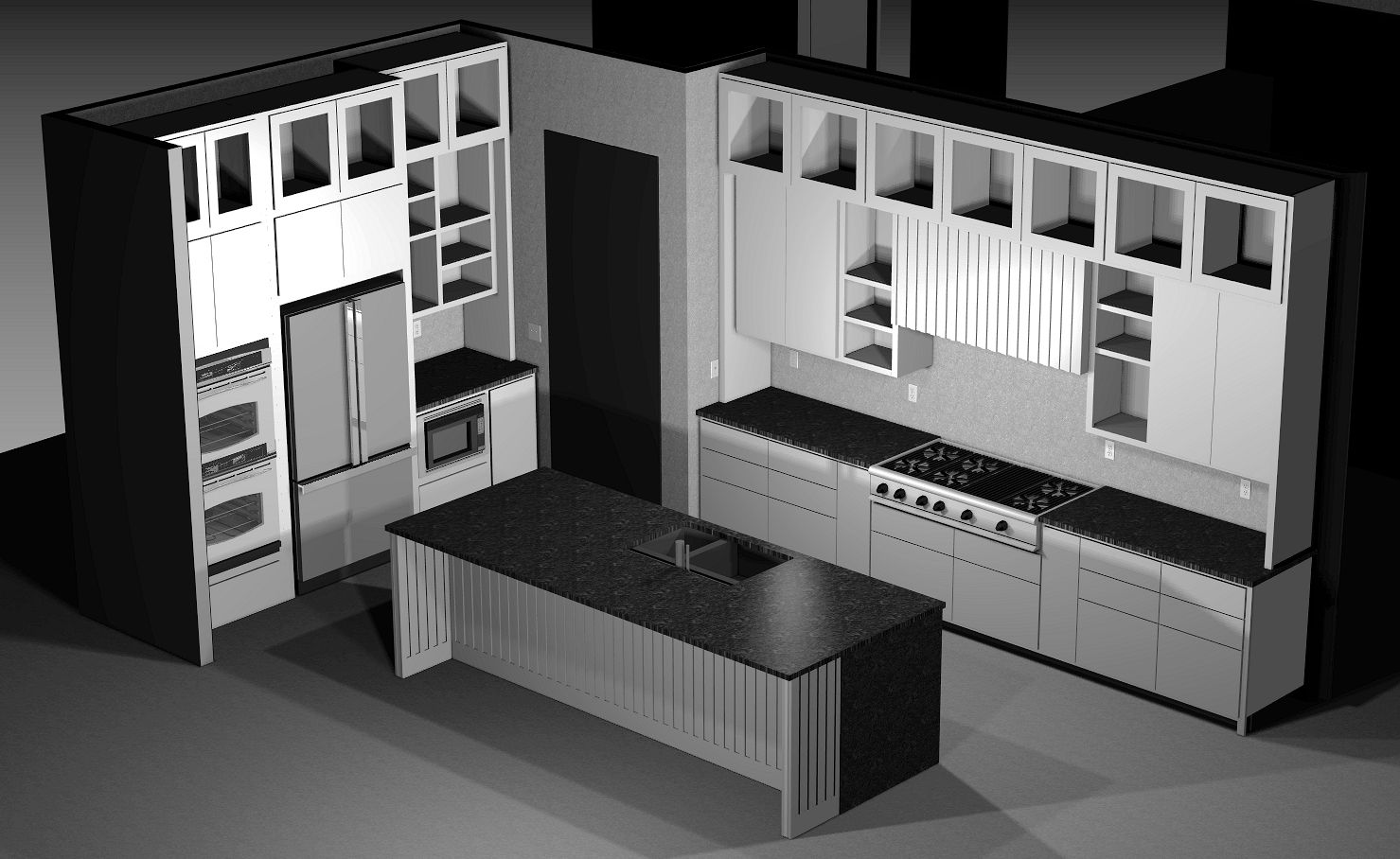

For my rendered presentation views, I just do the Full Render and use the Windows Snip Tool to grab the part of the images that I want to use and paste them into IrfanView or Paint Shop Pro to finish them off. (I normally just sharpen the image and convert them to greyscale, so clients aren't distracted by the colors in the image.)
Thats a very nice job Kerry.
Do you not get any image when you do a Presentation View?
The view stays the same as in the enhanced view.
The Calculations take place but the image stays the same as enhanced view and the shadows and lighting effects don't show on the screen. (so I don't see a preview of the render)
But if I use the save Jpeg button after it does its calculations, the image is saved with all the shadows and lighting effects.

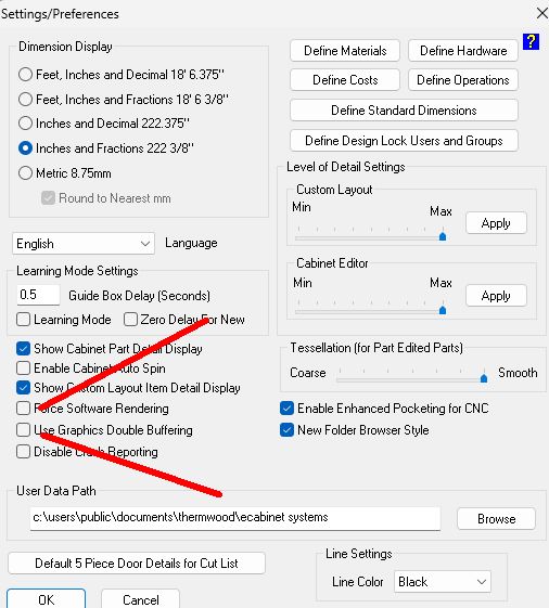

Just for fun, try checking these two boxes in Settings/Preferences (maybe one at a time) and see if anything happens.
Hi Kerry.
It was good fun. :)
That worked. Thanks for that.
I should have checked that one too. :?
Definitely loosing it. I think because it used to work, I figured my setup hadn't changed.
Thanks for taking time out of your day to help solve my issues :D

I think I did an update to my video card and that or a windows update broke it. For some reason I feel like my video card isn't working anymore and it's using onboard graphics. When I run a test on the card the results are good so can't figure that out. I remember those two settings were for computers with crappy cards so I never thought of turning them on but will give it a go.

I just switched to force software rendering and it render on screen again. ¿does that mean it is not using the GPU anymore?
¿what's the use of higher end hardware if it doesn't use it ?
It was working fine in the morning, just suddenly in the middle of rendering trials it failed. So curious.
