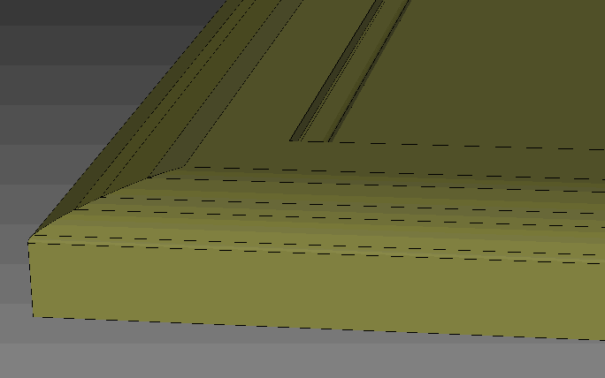

On the Profiling tab, at the top is to set the default Tool Group and Custom Tool. You can choose the bullet to tell Control Nesting which one to use for all the regions. If you want a different Custom Tool (shaper bit) (by “shaper bit” are you referring to a off the shelf, solid carbide profile tool and not a modelled profile) Correct Tool Group for different regions, in the lower section you pick a region number, then pick if it is Tool Group or Custom Tool, and set it accordingly. Below is an example of a door I did for a customer.
Region numbers are assigned in the order you sweep them. First profile swept is Region 1, second profile swept is Region 2, etc.
Region 1 was the outside profile. It is set to model with the tool group 1in MDF Curved Edge.
Region 2 was the shaper tool swept for the stiles and rails. It was set to use the custom shaper tool.
Region 3 was a sweep at the top of the shaper bit to clean the corners from the flat of the tool. It was set to use the 1/8" endmill as a custom tool.
The Default section at the top of the dialog will only be used if there are more than three regions. The first three are assigned specifics outside the defaults. In this case, any part that is loaded and has profiles, the first three regions would be cut the same way as the door.
(Sorry I don’t understand this “the first three regions would be cut the same way as the door”) For example, if I have a filler panel that has a beaded profile on it, five beads swept separately in Part Editor. If that filler panel is the same material I have set for my doors, Region 1 would use the 1in MDF Curved Edge modeling group for the first bead, tool #2 on the second bead, tool #9 on the third bead, and the 1in MDF Curved Edge modeling tools for the fourth and fifth bead. Regions 4 and 5 were not defined in the Default by Region section so Use Tool Group at the top is being used.
These region setups can be done on a per group basis, so for this customer, they have several door styles. Each door was made with a different material so it could be in a different group to obey different profiling tool setups. This alleviates them having to go in to change tooling setups for different doors.
