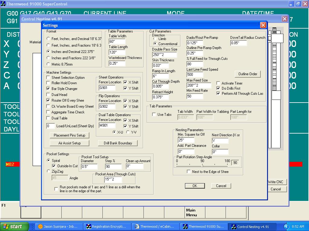

Jason Susnjara
Posts: 1653
Post by Jason Susnjara »
Hi Dan,
RN has a settings area that allows the customer to change the settings to work for his/her preference. Here is a pic of the settings screen. There is also a tooling area that allows the user to control which tooling for which operations such as dados, drills, outline.
It looks like the file paths cannot be changed then, correct? If so, can you email me a list of paths and file types to backup?
