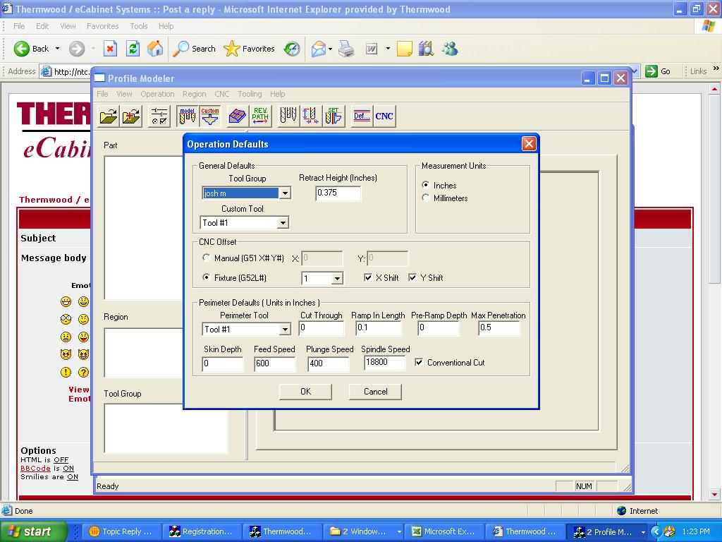

ok i finally got some time to mess with the profile modeler, created a part and generated code, but no outline cut, am i missing somthing here?, do i have to run the part through rolling nest to get the blank and then reposition the part and use the profile modeler to generate the rest of the code?

brian: i have not spent too much time with the profile modeler, it apears to me that there is a long way to go with it and i suspect that thermwood will be adding features in the future, when ecabinets supports import of dxf files the profile modeler will be of more use to me, but for now i cam create these parts with much more control in other software, i am hopeful for this program as it will be nice to only have to make the part once in one program and not ave to write tool paths for it. i look forward to seeing your sign, when you made parts using the profile modeler did it perform an outline cut or did you have to do two operations?
jason: yes i am running the current version, is the profile modeler soposed to perform an outline cut, or does that come from rolling nest?
Jason Susnjara
Posts: 1653
Post by Jason Susnjara »
Jeff,
If you click on Operations, Defaults, you will see Perimeter Cut allowing you to specify an outline tool with other settings.
