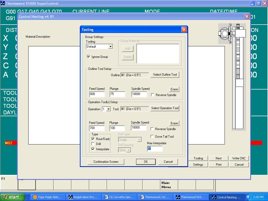

Hi Zach,
You can actually have any cutter interpolate those holes but the smaller you go the more material there will be left in the center of it. Here is a picture that shows the setting. It is located when you open Rolling Nest and click on the Tooling button. For each operation you can have a max interpolate set to a number that is bigger than the tool. I have mine set at 5\". I use a different number at shows because using a .5 tool will leave some material in the center of that hole because it is 5\". I will then pocket that out. But for kd's and hinges, I use a .5 tool for the circle interpolating.
Zach Froble
Posts: 171
Joined: Tue, Jun 21 2005, 3:23PM
Location: Connellsville, PA
Post by Zach Froble »
Jason,
Thanks for the quick reply, like always you guys are on top of everything when it comes to helping us out.
