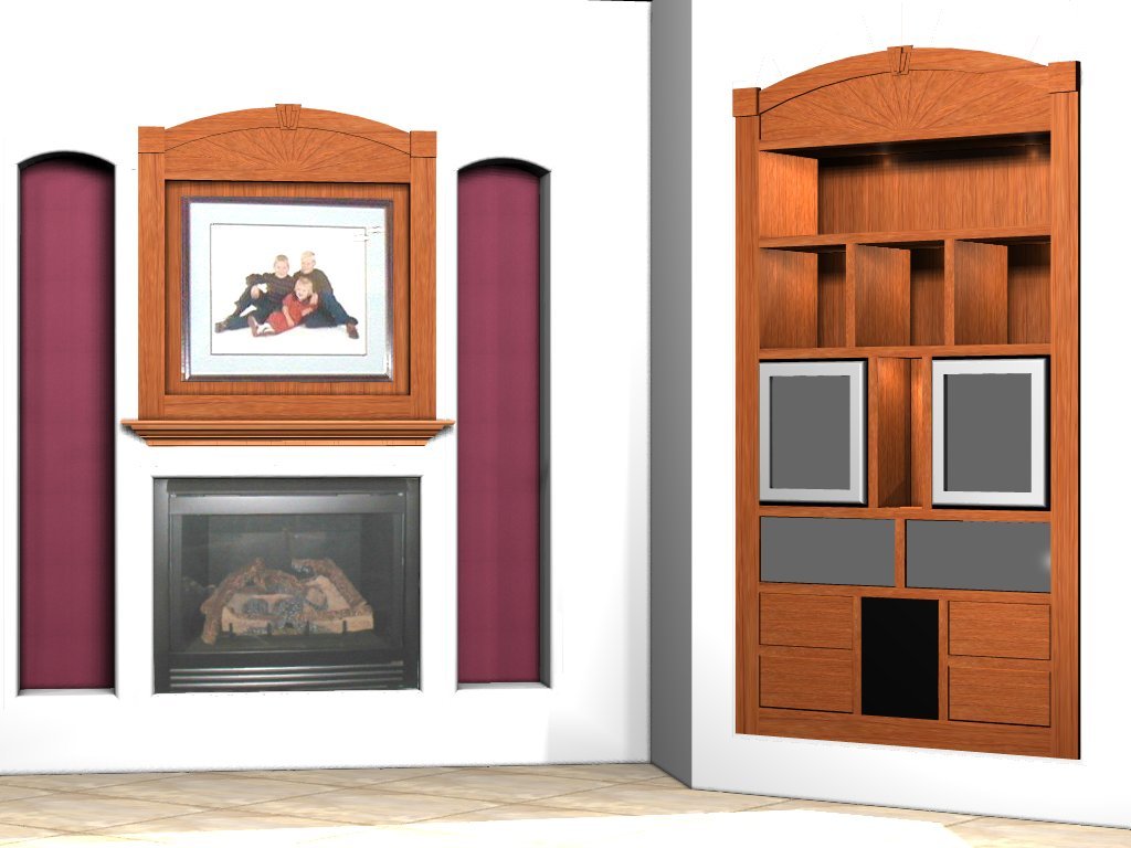

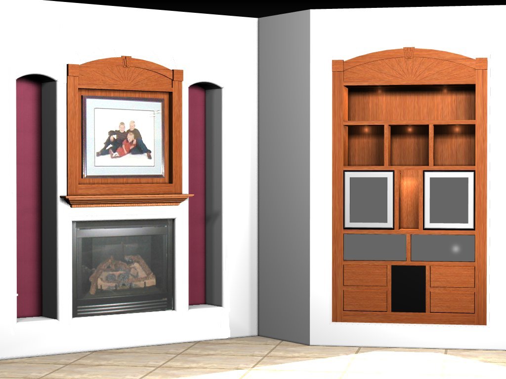

Peter, here is the layout I was talking about. I have can lights in each of the openings and about 9 dome lights up and down the front of the main unit and about 12 more dome lights around the perimeter of the room. If I turn the lights down you cannot make out the sunburst above the two pieces or the rosettes (that don't exist yet, that is another problem in another thread) or the edge profile (that also doesn't exist in these pics).
Anyway, this is the type of thing I run into here in the greater Phoenix area. Many houses have these drywall pockets that are typically used as entertainment centers. They are functional but not very attractive. Luckily, some folks know that this can be fixed with a little imagination and some wood! I just wish I could find more of them.
This particular unit has a couple of wine cellars (the fridge units in the center) a few drawers for media, an audio cabinet with grey glass doors, a small area between the drawers for the subwoofer (I had small speaker cabinets in the unit that balanced it a little better but the client wants to keep them wall mounted where they are now) and some display shelves. I also am filling a pocket over the fireplace and using the same sunburst to kind of tie the two pieces together.

Try using a more gray color for the walls. It won't wash out so easily and will help to highlight the cabinets more. You can show the detail better by placing the lights almost straight from the side so as to cast shadows in the detail areas.
Nice design.

Nice job. Dan may be right about positioning the lights. You should be able to catch more of the carving.

Rolf,
The trick in lighting is not using too much.
I would light that room with three dome lights.
One over each cabinet area approx 5 foot from the wall at ceiling height and one centered between the two cabinets 5 foot from each wall and four feet off the floor.
One of the tricks is to make sure every texture you place in a room has shine. Walls 1 or 2. Floors 2 to 3 wood textures 2 to 4 at max
For your sunburst it is nice to use a slightly different texture for carvings and moldings so that you can give them just a bit more shine to bring them out
Less is always more.
I light the room so that it looks natural then I take the jpeg to irfanview and use Gamma correction and brightness and contrast correction to finish it off.

I hear you. I normally do retouch my images, I left them alone here to show the native image. For this customer, I did close ups of the details and had a full view that was retouched and looked better.
I try to use alot of light because here in the desert it is always sunny and the houses, to the detriment of water levels everywhere, are flodded with natural light. The main problem I run into is unnatural shadows. I place a light down low or to the side because the area is too dark and then I get upshadows and side shadows that look bad so I add another light somewhere to kill those shadows and so on and so on. Don't get me wrong, I like the dimly lit library look, I just don't see much of that here.
I will play around with the shine factors and see how that works out.
