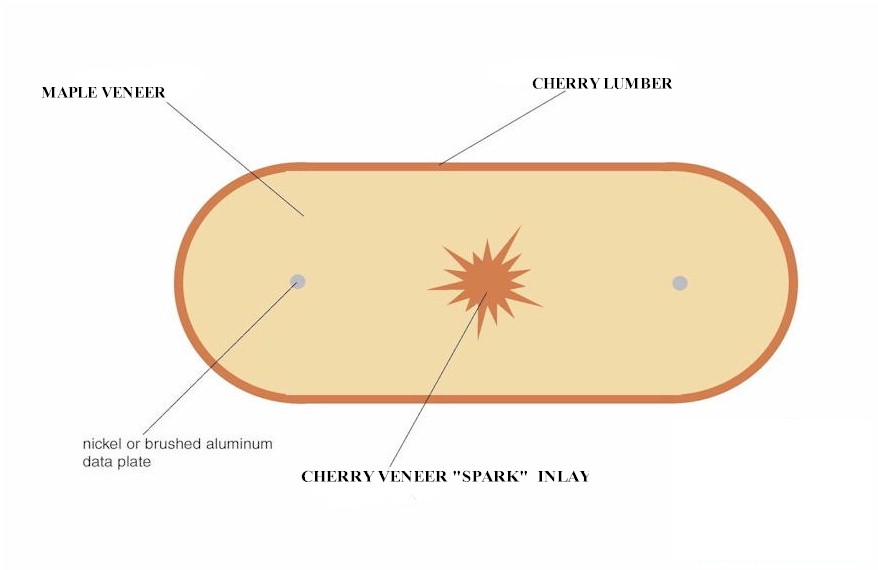

Hi,
Is it possible or has anyone tried to cut a large Veneer inlay? The attached photo has a Maple Veneer field and in the center a Cherry \"Spark\" Inlay. I have a veneer supplier that can make this at his shop, i was just curious if it could be done on the CNC machine. The Conference table size is around 96\"x36\" Any suggestions or comments would be greaty appreciated!
Dave

Hi Dave,
I wouldn't see why you couldn't do this. The only question would be the spark in the center with the sharp edges. You would have to go to a small tool to get close to it and then maybe some hand work to get the sharp edges like where the star comes to a point.

Thanks! I was just curious, if anyone has cut shapes out of veneer.
If we would try it, i will let you know how it turns out
