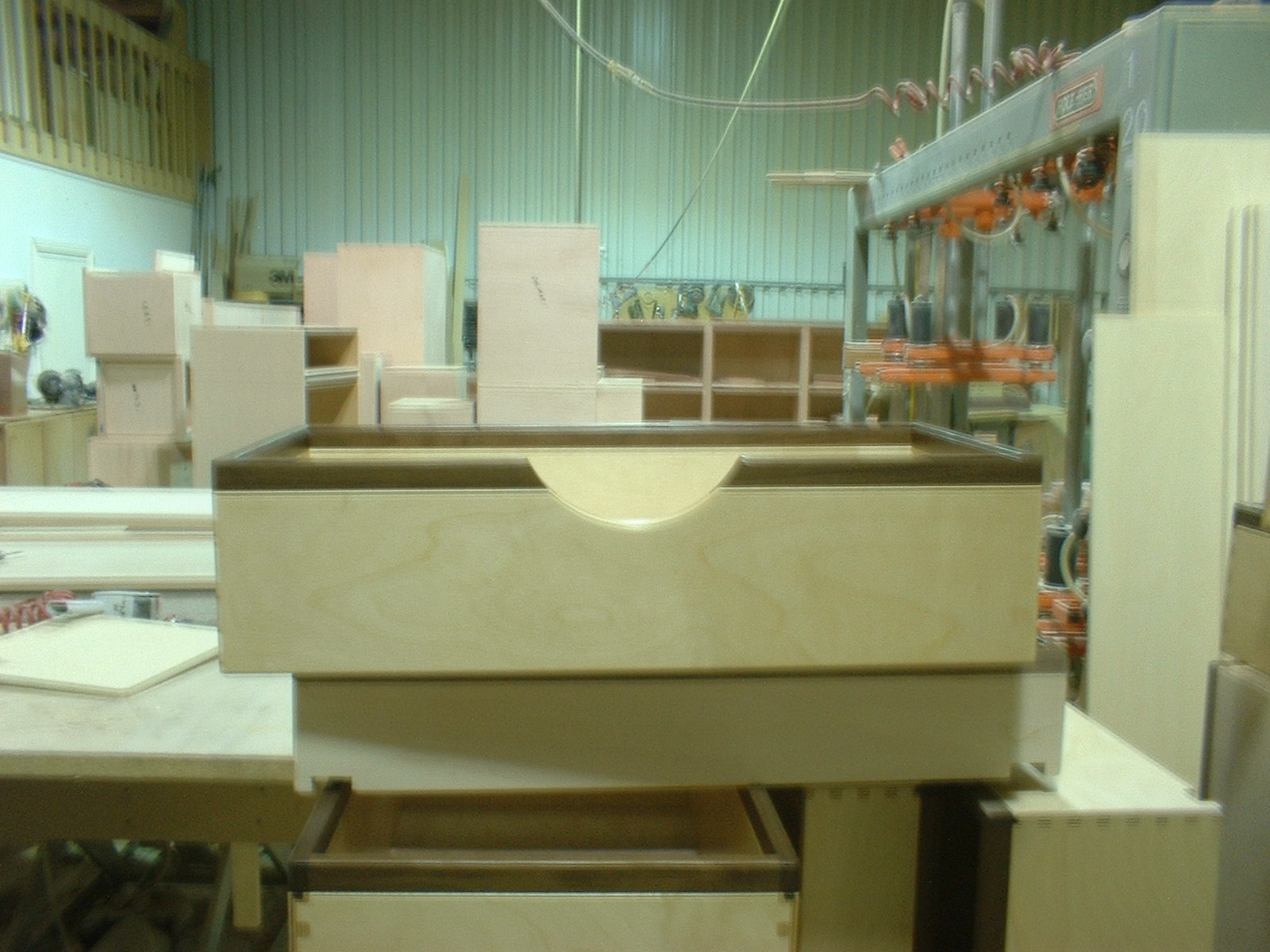

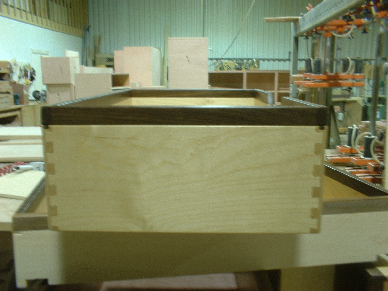

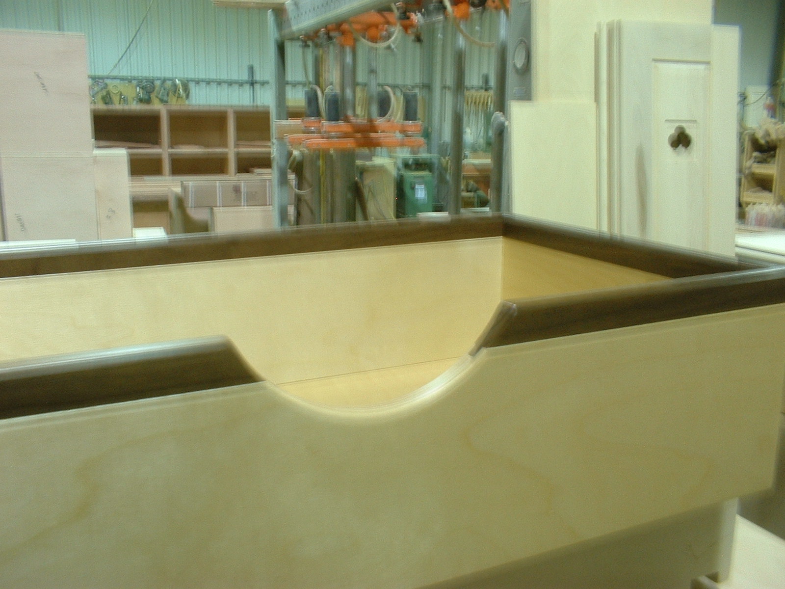

Here's our dovetail drawers for a kitchen going to Cape code. Made of baltic birch, 1/4\" bottom and with our special touch, a solid 1\" walnut edge with a vgroove to split the walnut and the baltic birch. They are made to receive tandem blumotion slides. What do you think about it ?

Those are very classy, Dan. Did your dovetail joints come out nice and tight? If so, what kind of tweeks did you have to do?

I did'nt touch anything, there's a little \"loose\" but only maybe 1/64\", next time I'll try to adjust it better, but we will have to play with it everytime you start a new batch cause it depends of many things I think, surfacing of the table, use of the tools,etc...

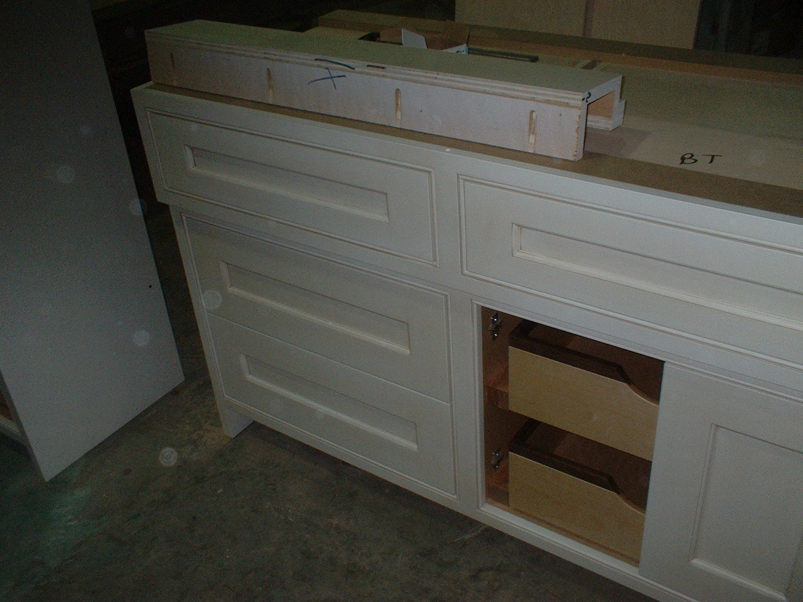

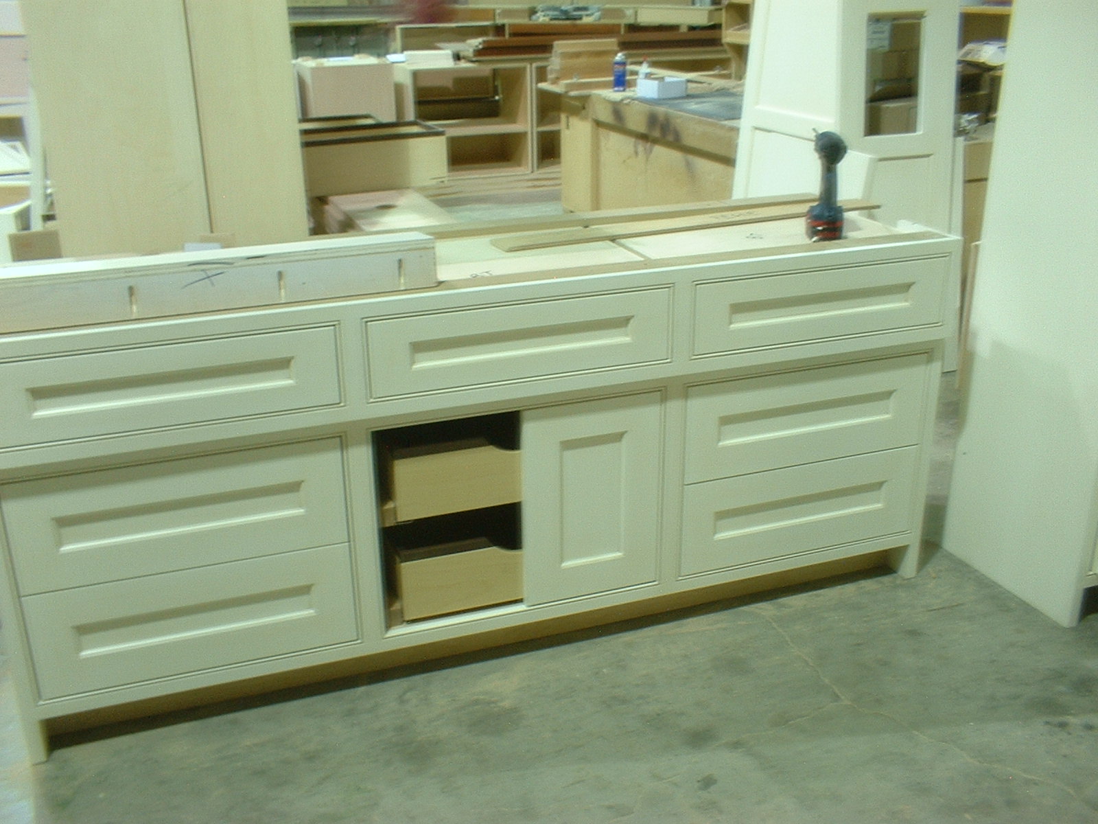

Some low quality pics
Post by DanFecteau »
You can't see the glaze cause it's light and the quality of the pics is very bad......I'll post some more pics later...

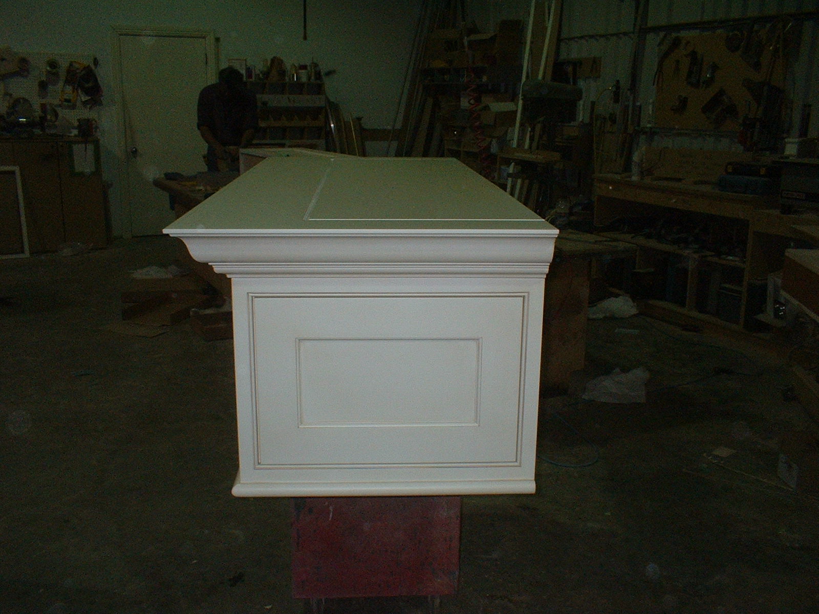

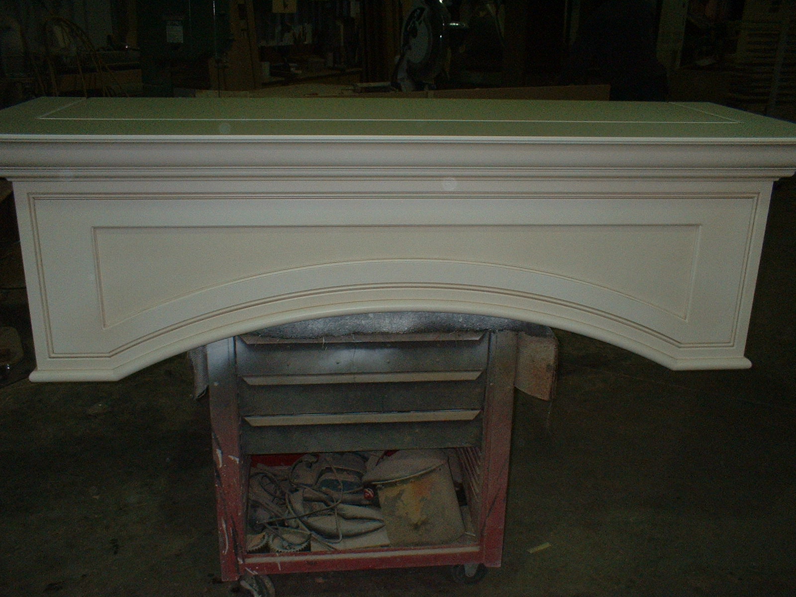

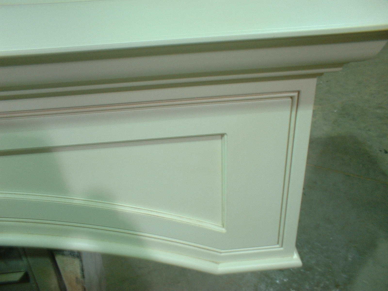

hood canopy
some pics of the hood canopy
