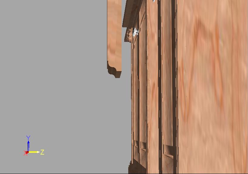

Here is an ogee tool. Alittle different than the normal bits you buy.

Thanks Ted that is exactly what I'm lookin for. Going to use it to profile plinth blocks at the base of fluted pilasters and for freeze molding at th top

You can play around with the settings in the profile window and set it to give different reveals. I think for that pc of wood I had set plunge depth to .5625.
