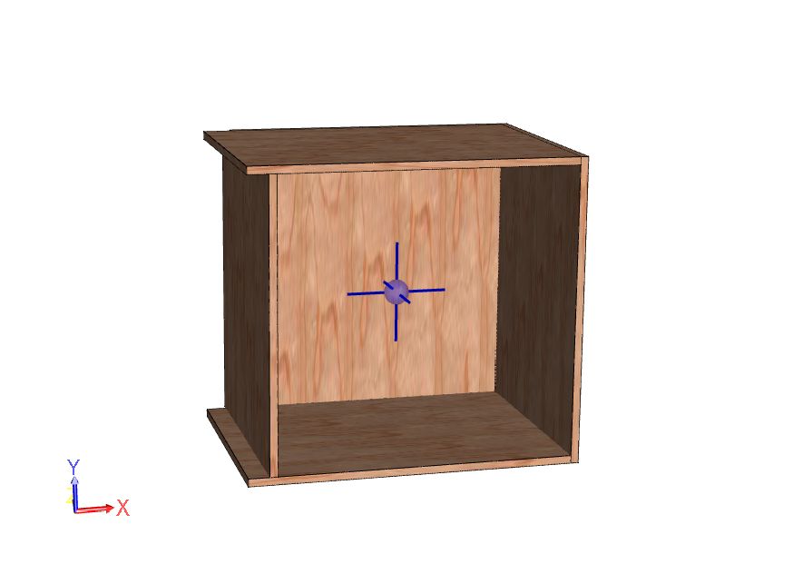

Hey, I knew that was only one question :wink:
If I understand what you want to do correctly, you can use negative insets on one side of the top and deck (as long as you have top flush and deck flush). What this does is make the top and deck wider while leaving the cabinet size the same.
You can use mixed flush and have the top and deck flush on the scribe-side while leaving the side flush on the other side like this example.
To finish it off you just need to add a display panel or board for your scribe.
Left Side Inset.jpg (32.78 KiB) Viewed 9111 times
I just thought of another method to do what you want.
Place a partition in the location you want and remove the end panel on that side. That allows joinery in the top and deck on the inset side. It looks the same but will probably work better for machining on a CNC.
