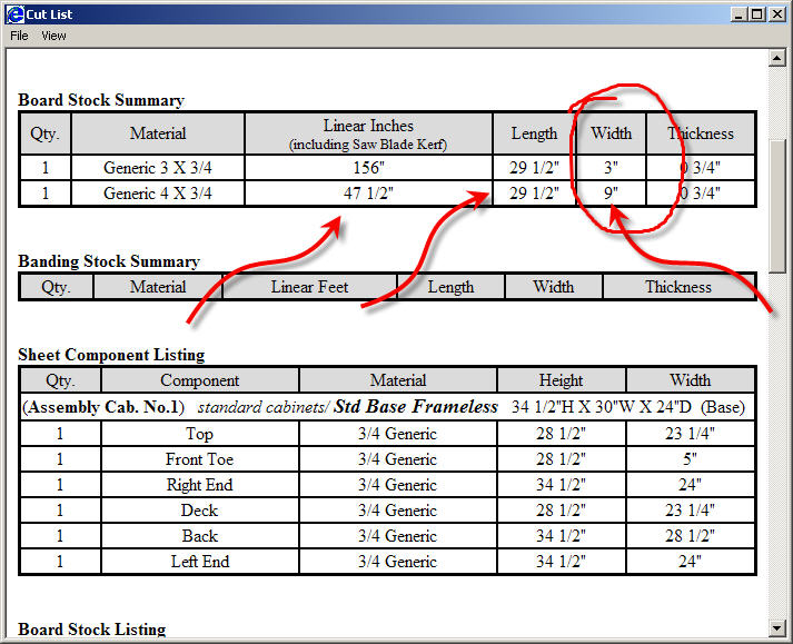

Also, when you do 5 pc doors in-house, the program asks you what kind of stock you will use for panel glue-ups, if the stock is less than the panel width, you have to glue up two or more stock boards, right? The cut list only reflects the length of the panel and not the width. In other words, the cut list is the same no matter how wide the panel is. Can anyone help?
First, welcome to the family!
To use board stock for components that are made from sheet stock, you can \"cheat\" the system by setting up a sheet stock with the same dimensions as your board stock (i.e. 1x12x96 = 3/4 x 11-1/4 x 96).
On the five piece door cut list, it is a little confusing and looks like the calculation is not quite correct.
If you notice, the width given in the width of the glued-up panel and not the board stock. The total length given is for that width and not the board width. See attached picture for a better look. The circled area is the width I'm referring to here.
I will send a bug report to Thermwood for this.

So...
how do we now figure the correct board ft with this unique situation. It appears that the board stock is way off but the inches may be more accurate. But then again yea just like I said Hu???
Just makes me wonder how this can change, if the material calculation is a subroutine based on a data base. Why the changes to begin with... Things that make you go Huuuuu?
We still need to know how to figure Bd ft with this.
