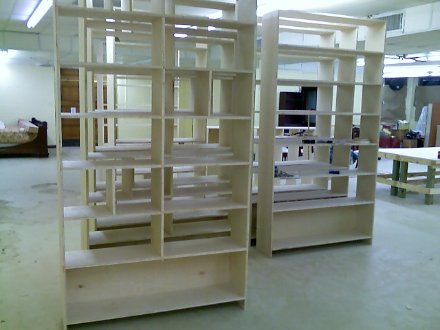

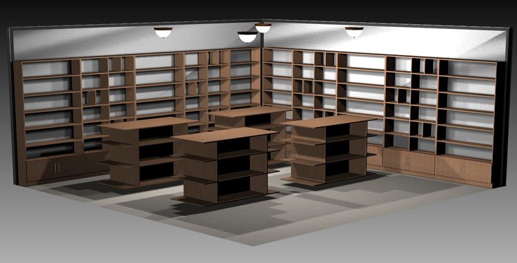

Here is my first go at this software, started on all this this morning and fixing to start cutting wood in about an hour. Amazing how this really speeds up the process... Love the nested diagrams, I will really save on lumber cost...

I just learned the software from the help files and 3 trips to the forums to look up answers to a couple questions... I did'nt see the tutorials. I have a background in software (I can write in several object oriented languages + some 3D experience) so picking up ecab was not that hard for me, I literally picked it up in just a couple hours, learned while I produced this job...

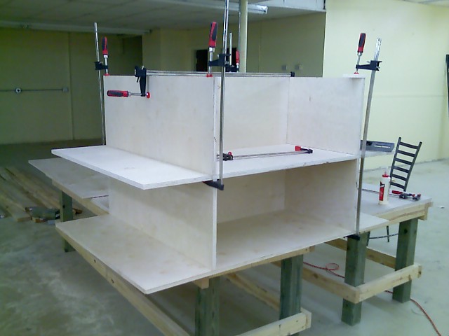

I found that I had a couple of fundamentally flaws in the way that I designed the product floor stands, I should have made the layers of shelves, partitions & center stretchers one level at a time and stacked them for better strength... Live and learn I figured it out before I burned through too many sheets of plywood...

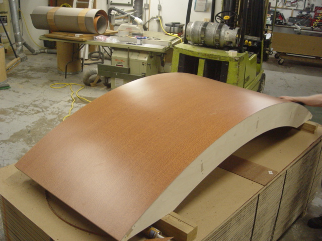

Below is a picture of a prototype that Dennis, The Ecabinet instructor, and Jason @ Thermwood have helped me with. The only thing, so far, that Ecabinets was unable to do, is make the arched trapezoid panel. I can make the arch/radiused panel but then I can not rotate it to make it into a trapezoid. I can bring it in as an STL but then it will only be for presentation purpose and not CNC-able.
Andrew let me know if I can help increase your production capacity.

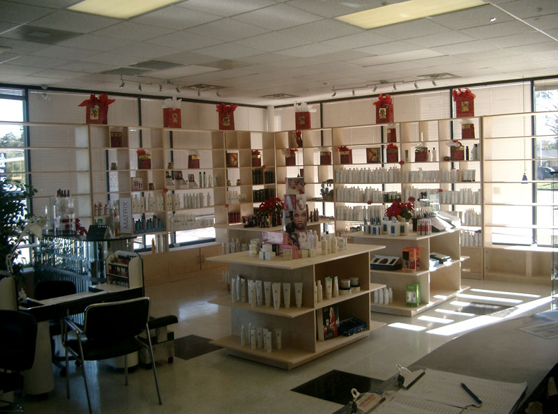

Here is a couple of photos of the job. It turned out really nice, customer is super happy. The wood we used was not that great (imported ply, cst choice) and created a lot of time in the finishing to get right... The Wall units are made with dado's and the floor stands with biscuts.
