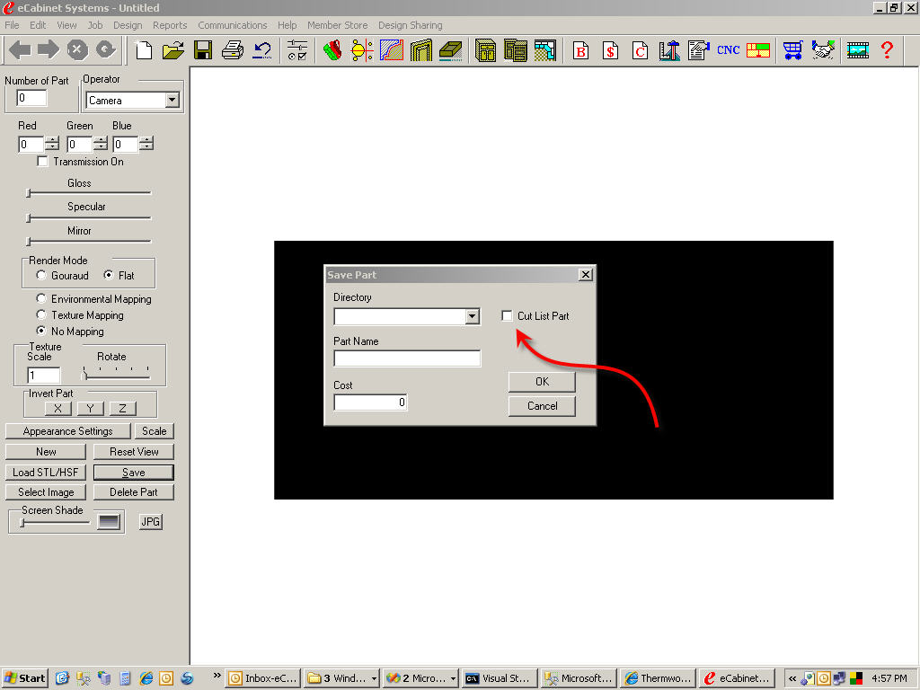

The check box is on the file save dialog when you create a display part in the display part editor.
I'm not sure what happened on the cut list for you. Try opening the cabinet editor with just the mantel and see if it shows on the cut list and cost sheet.

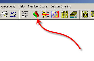

First, I can find no check-off box in any dialog I get as you describe. Can you describe exactly which editor you are in and how you are making and then manipulating the part? Most of my display boards/sheets are not modified in the part editor but are merely trim boards with simple dimensions and get placed in the cabinet/assy accordingly.

The check box is in the Display Part Editor, not the Part Editor (see attached images).
The cut list works like this--if the unit has not been nested then total square inches are used for sheet stock because it has not been optimized yet. Once it has been nested it shows the correct amount of sheet stock.
Cut List Part.jpg (93.59 KiB) Viewed 11760 times
Display Part Editor.jpg (14.12 KiB) Viewed 11786 times
