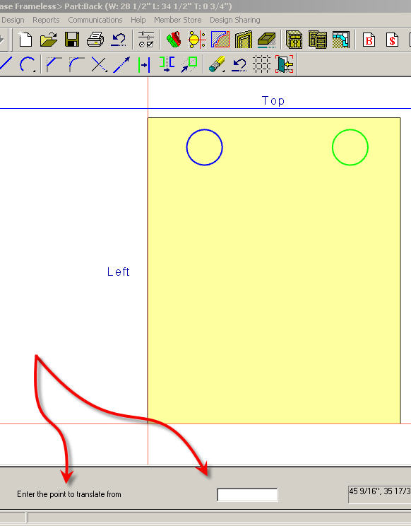

In contour mode, Kerry says to draw your first line and then copy that line and space them out across the board.
After drawing the first line, I select it and it changes color and then I go to the copy icon and click on it and select copy.
I go back to the board and click on it expecting a line to appear, but nothing happens.
Could someone give me a step-by-step on what to do?
Floyd
There is a box at the bottom of the screen where you have to enter coordinates to copy from and to.
