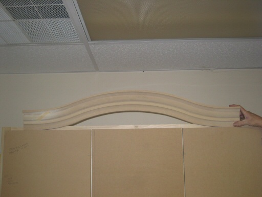

Post by Paul Huff »
These are the steps to make the arch crown. I used a display panel to make the blank. I just made a sheet stock the depth I wanted my crown to be. I took the piece to the part editor and loaded my dxf into the part editor. (You can draw this in eCabinets, without the extra cad program) I selected create part using a closed contour. Then I set a partial tool path on the bottom edge of the crown. And selected my profile tool and it was done. Sometimes I have trouble with some profiles and get the not possible error. That is why I make my profiles cut to the right and left. It lets me try from either end.

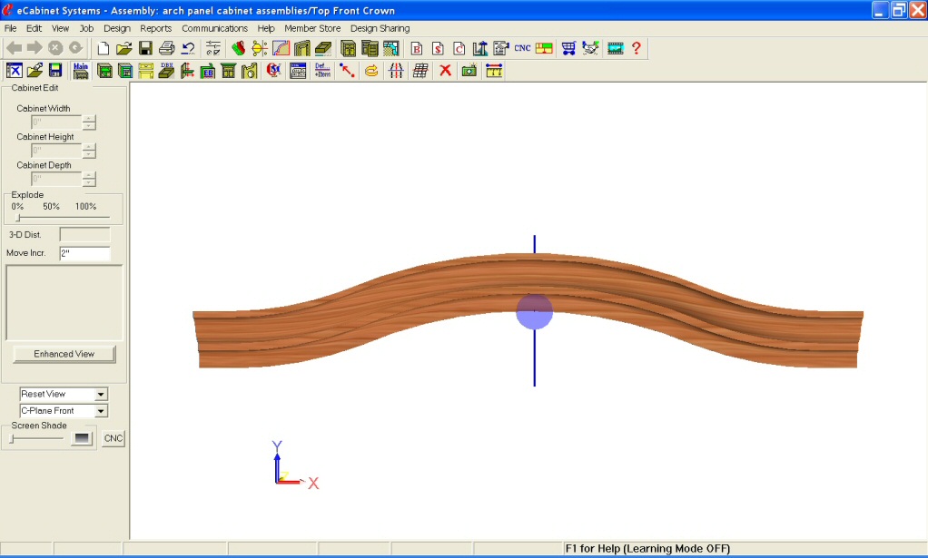

Nevin Anderson
Posts: 9
Joined: Wed, Aug 09 2006, 1:53PM
Location: Victoria, TX
Arch top molding
Post by Nevin Anderson »
Dan and Paul,
The problem I'm having is making a smooth S-shaped curve within e-cabinets. The only place a smoothed curve drawing tool is available in the software is in the shape manager. It's not available in part editor or contour manager. I can easily make an arch with the 3-point arch tool, but an S-shape requires stringing two or more arches together, and I haven't found a way to do this and produce a smooth flowing line. The result is OK for show and tell until I cut a profile into the molding. Then the software forces me to cut that profile in two separate steps because there are two separate arcs even though their ends meet, and the slight inaccuacy where the curves meet is amplified by the molding profile cuts and is very noticable. If I could figure out how to draw a smooth S-curve that could be profiled in one operation within e-cabinets, I wouldn't have to draw it in a CAD program and import it into part editor.
Thanks again,
Nevin
Do you mean like the attached image?
For this I started with a 10x20 display panel. In contour mode of the part editor I placed two the-point arcs on the panel. The coordinates were 3,0;5,5;3,10 for the first one and 3,10;1,15;5,20 for the second one.
Then I selected \"Create Edges\" from the right-click menu. Next I extended the outer ends of each arc past the edge and trimmed them. Then I deleted the orphaned edge line and returned to the part editor where I used \"Create Part using Closed Contour\".
Just make sure you always enter the coordinates instead of trying to use the mouse to place your arcs (and other lines) in contour mode.
Paul Huff
Posts: 95
Location: Lubbock, Texas
Post by Paul Huff »
I just wanted to let everyone see that this is possible and promising. I can only imagine some of the cabinets and designs that will come from the new capabilities of eCabinets and a Thermwood CNC . We are very excited about the possibilities.
This was just a test piece, I did learn a bit by watching it cut. I am going to change the profile before we make the final part. It may be a while before we make that cabinet, so I will have time to experiment with some different ideals for it.

Post by Paul Huff »
I used carpet tape to hold the piece down but as you can see it moved. This happened while I was outlining the part. It was my fault for just putting the tape on in a couple of long strips it moved while cutting the outline on the end (should have been taped vertical and horizontal, I think). Since it was a test I just taped it down again and finished cutting. The test was not to see if it would move but to cut and see what we would need to do if cutting lumber.
I know some other ways to hold the materials down but should probably be discussed in the Thermwood forum instead of this one.
I guess the thing to see here is that you really are modeling 3d parts with eCabinets and that a Thermwood CNC can really whip them into reality. I like the way that the programmers have chosen for 3d modeling. It is a concept that most wood workers can understand quickly. Take a bit and make a cut. Does that sound familiar to anyone?
I didn’t really time the cut that close. It was probably an hour or so. But I think an hour or more spent here could add a lot of value to a cabinet.
