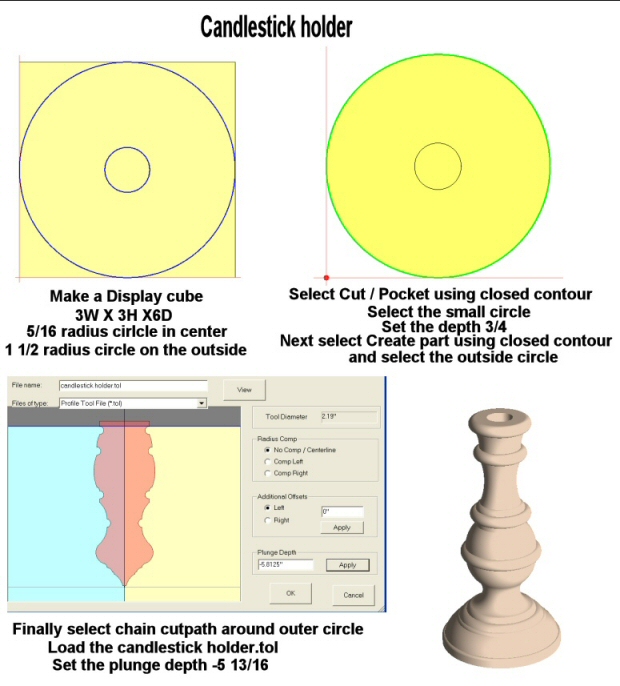

:D This one was fun to make. The zip contains the tol file and the x_t file. Please feel free to make it your own.

Looks like we have a wildman on the loose with a new toy :lol:
I like your unconventional use of eCabinets Paul, it shows that anything is possible if you \"use common tools in uncommon ways\" and have a little imagination.
If you remember the rendering of Thermwood's office expansion, it was done in eCabinets.
