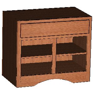

Yes Rick, that's what I had in mind. Too bad I didn't see it in time, ended up going a different way using Forrest's suggestion with the .001\" toekick. This way I had what I call a dust stopper behind my decorative faceframe lower rail. I see how you did it with the -5.75\" FF inset, nice trick. I didn't think that would have done that and didn't even enter any numbers into that parameter. Here is what the cabinet ended up as. This is my 2 door seed, I have a single and a 3 door as well as a corner with a lazy susan. Building them up. Thanks again.
