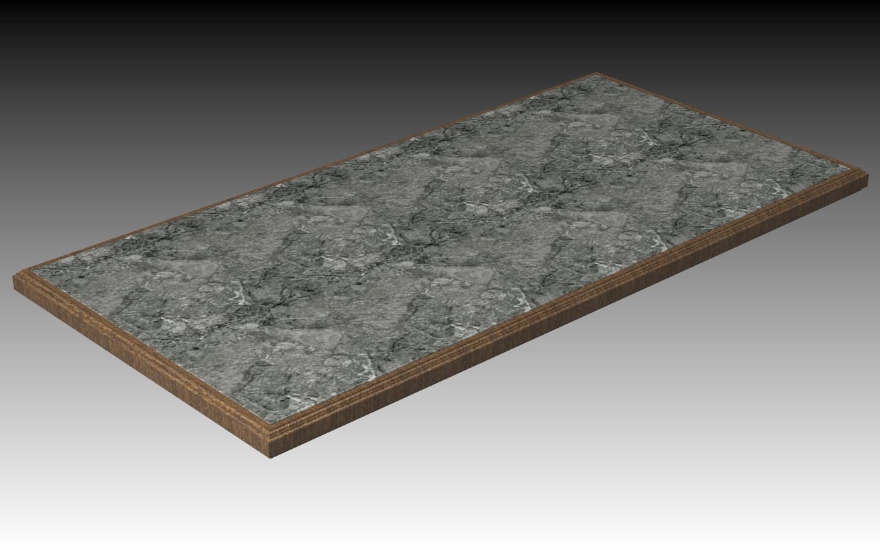

Display cubes Peter, display cubes. Just like version 4 before countertops were included.
Peter,
This is one display cube with the center cut out and a profile run on the edge for the wood and another display cube for the marble center.

OK,
Thanks guys, I figured it was going to be a display part type job but, hope springs eternal.
