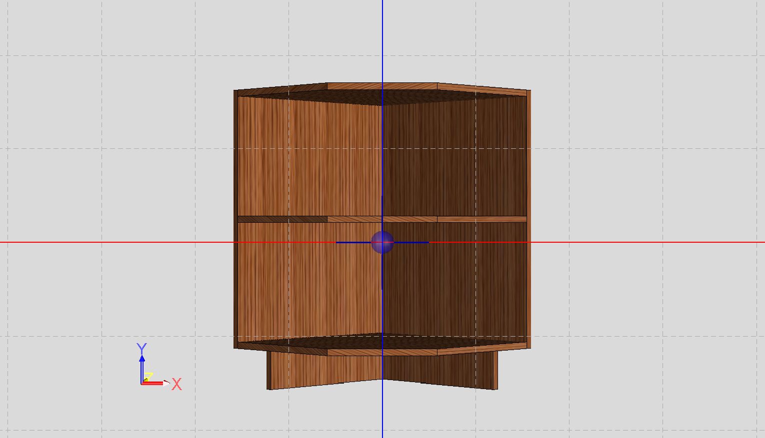

Hi All,
I would like to create an outside corner base cabinet with an angled front and am having some difficulty. I did not see one in the standard cabinets so I started with an inside corner cabinet and have been attempting to modify it, but am not certain how to create the toe kicks on the \"backs\". Do I need to modify these in the part editior?
Am I approaching this correctly, or is there an easier way to create an outside corner cabinet?
Kevin

Post by KevinDunn »
Here is a quick update on my progress, (minus a few hairs pulled) I used the part editor to cut the toekicks, but when I try to change the depth of the right and left backs (this started from a standard corner cabinet) I get a message indicating this will result in an unstable cabinet. Current depth is 24\", I am trying to set it to 18\"
I am sure this is a clear case of operator error on my part :D Any guidance would be greatly appreciated.

My cabinet is very much a work in progress. I am still struggling on the learning curve with the SW, but slowly making progress. I planned on the cabinet being a face frame with a single door on the angled surface, and yes a toekick :D
I'm not sure if I was attacking this properly. If you have any suggestions to point me in the right direction that would be great.
Kevin

Kevin, I think you are on the right track, but instead of cutting the kick out of the back, why not use a detatched toe kick undersized the amount you want the depth to be?
Joe
