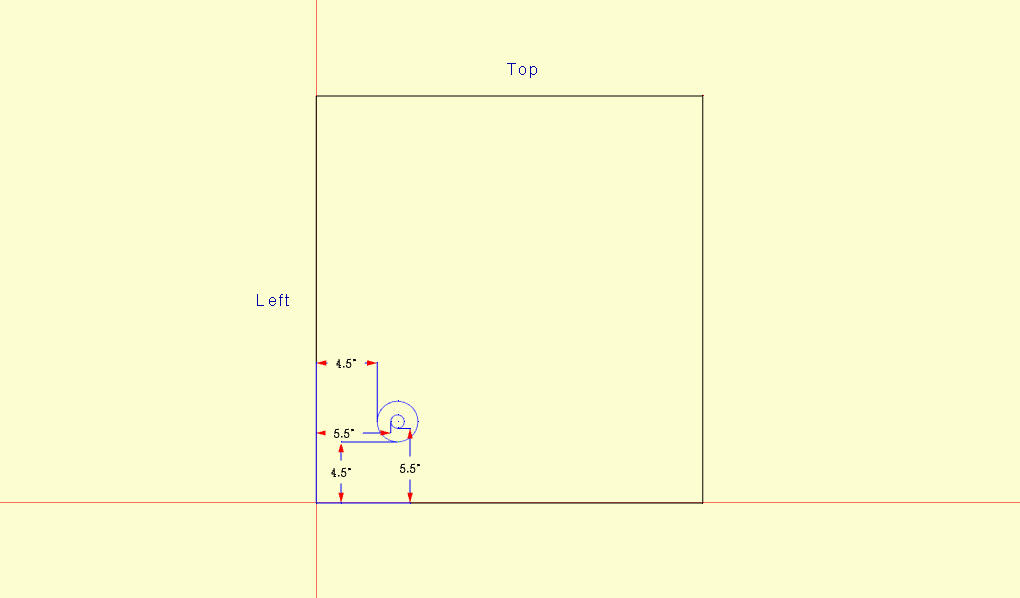

Try the constraints like the attached picture. In this instance the holes are located at 6,6. The through hole is 1\" and the countersink is 3\" in diameter.
The outer edges of each hole is constrained to the edge of the part as indicated.

Dan, you genious! 8)
i hadn't even thought to try constraining the quadrants of the circles, i was always using the centerpoints. i erased all the centerpoint dimensions and replaced them with quadrant dimensions and now it all works just fine! thanks a bunch
