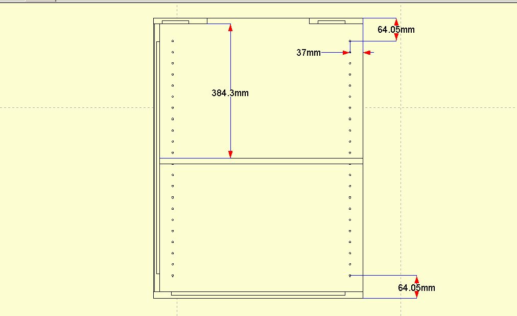

Dave Robertson wrote:Good morning all, I'm looking for some assistance in setting up line boring patterns in the program. Our frameless boxes have 5/8 (16mm)gables and 3/4 (19mm) decks. We always reference our holes from the bottom. We built boxes at 31 1/2 H ( 800 mm ) so that gables could be used as lefts or rights. When we use Grass's Zargen slides and 3/4 decks we have issues of not having enough clearance underneath. When using these slides we now have to go to 31 5/8 ( 803 mm ) gables. This is all background to my question of how do I input to the program my first 5 mm hole 64 mm or 67 mm from the bottom and 37 mm back from the front edge and then every 32 mm up? Thanks. Anyone else use Zargens with 3/4 decks?
Is this what you are looking for Dave?
I just changed the opening for the top of the shelf to equalize the pin holes. You can set your back and front insets while in shelf editor construction settings.
