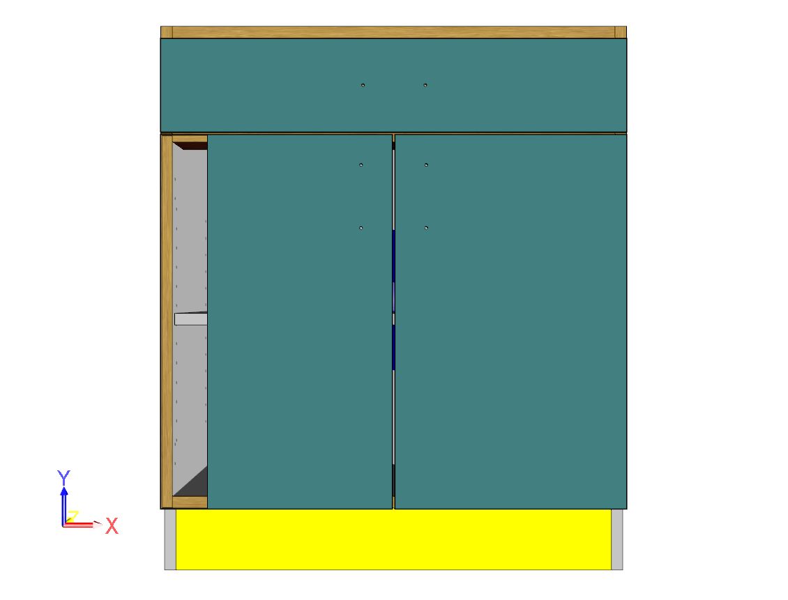

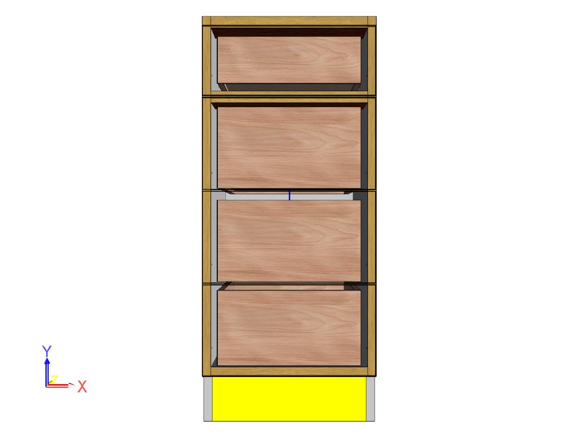

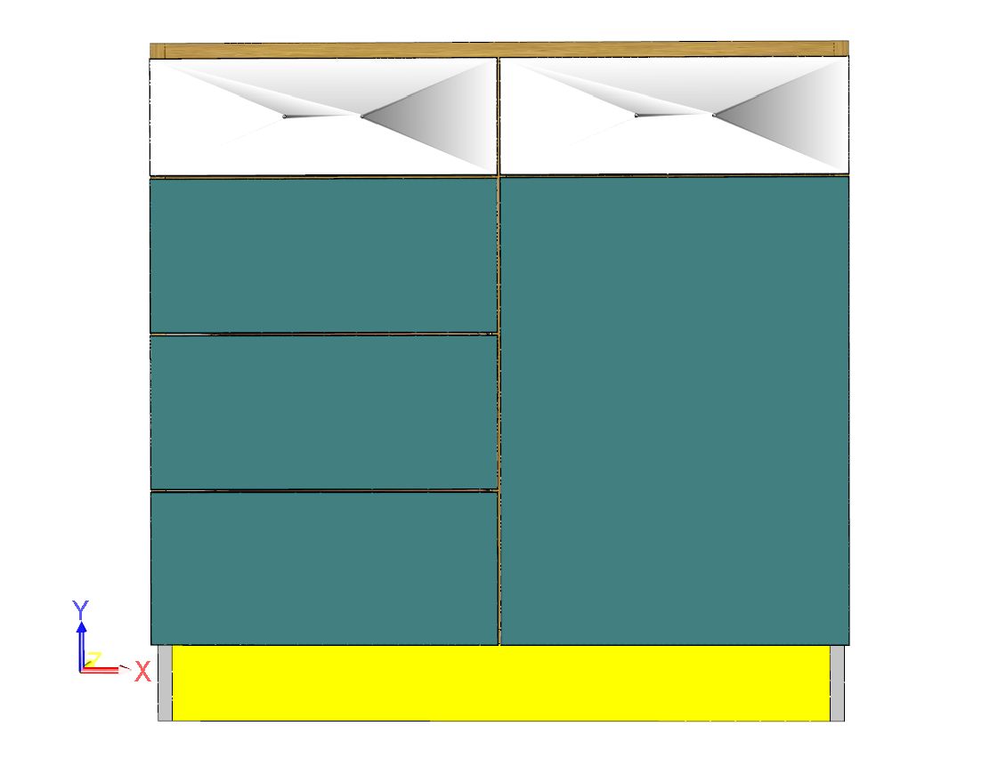

I am still getting wierd results with my doors after 5.1 bld 2. I read that this was fixed in this build. I have a couple scenarios where transparent doors are created. Most of the problems occur with drawer banks. I notice that after I add a door then take it into part editor to make the handle pattern the door will turn white when it is regenerated going back into the main screen. Then I take the door to the constraint manager, put constraints on it, then return to the main screen. At this point if it is a drawer bank some or all of the fronts become transparent. Sometimes if they are just double doors the color will return to the door. About 99% of the time a door with part editor cuts, banding, and constraints will have some sort of \"body\" problem when resized. Attached are some jpegs of what I am talking about. I emailed the job with all these cabinets in question to some techs to look at. If you need any more information let me know.[/img][/flash]

Chris Say
Posts: 142
Joined: Fri, Jun 23 2006, 9:02AM
Location: Gilbert, AZ
Post by Chris Say »
You asked a good question. The reason why I go to part editor is to put the handle hole locations on the front or door. I then go to constraint manager and put constraints on the hole locations so when I go to re-size the cabinet the handle location stays in the same relation to the location I originally placed it. I hope that makes sense.
