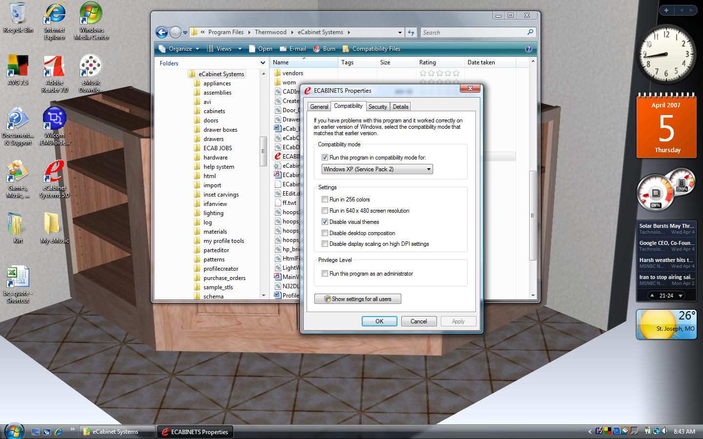

I haven't done anything with Vista (not going to for a while either :wink: ), but does it have \"Compatibility Mode\" like other versions of Windows?
In Windows Explorer (or whatever its new name might be), browse to the eCabinets directory. Right-click on eCabinets.exe and choose \"Properties\". If Vista is like XP, there will be a tab labeled \"Compatability\". On that tab is a dropdown that you can choose to run the program in XP compatability mode.
I don't know if this will help but it is worth a try.
Compatability Mode.jpg (39.73 KiB) Viewed 15563 times

Hi Drew
this is what I am currently using on my dell inspiron e1405
