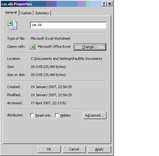

To change the program that is used to open excel files:
Open explorer
Right click on any file with xls extention
click on properties
On the General Tab, if it does not say Open with: Microsoft Office Excel
you can click on the Change button to change it
HTH
