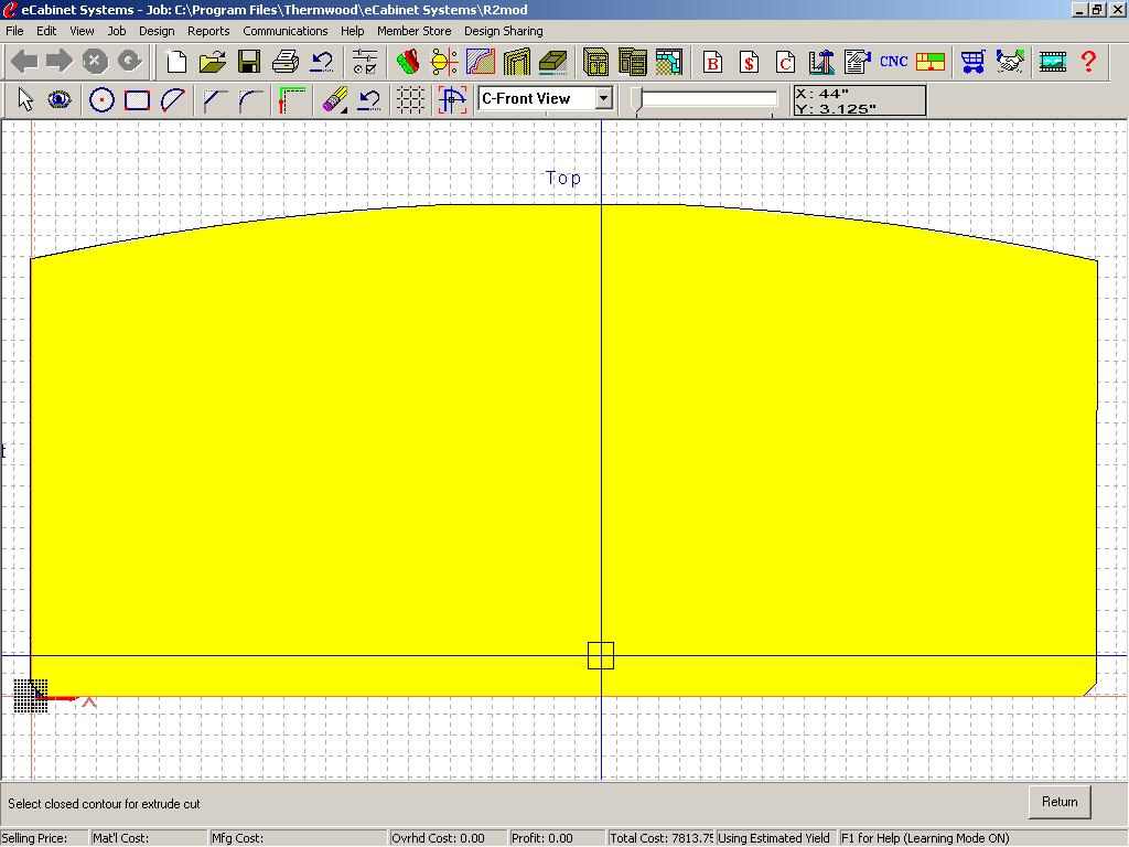

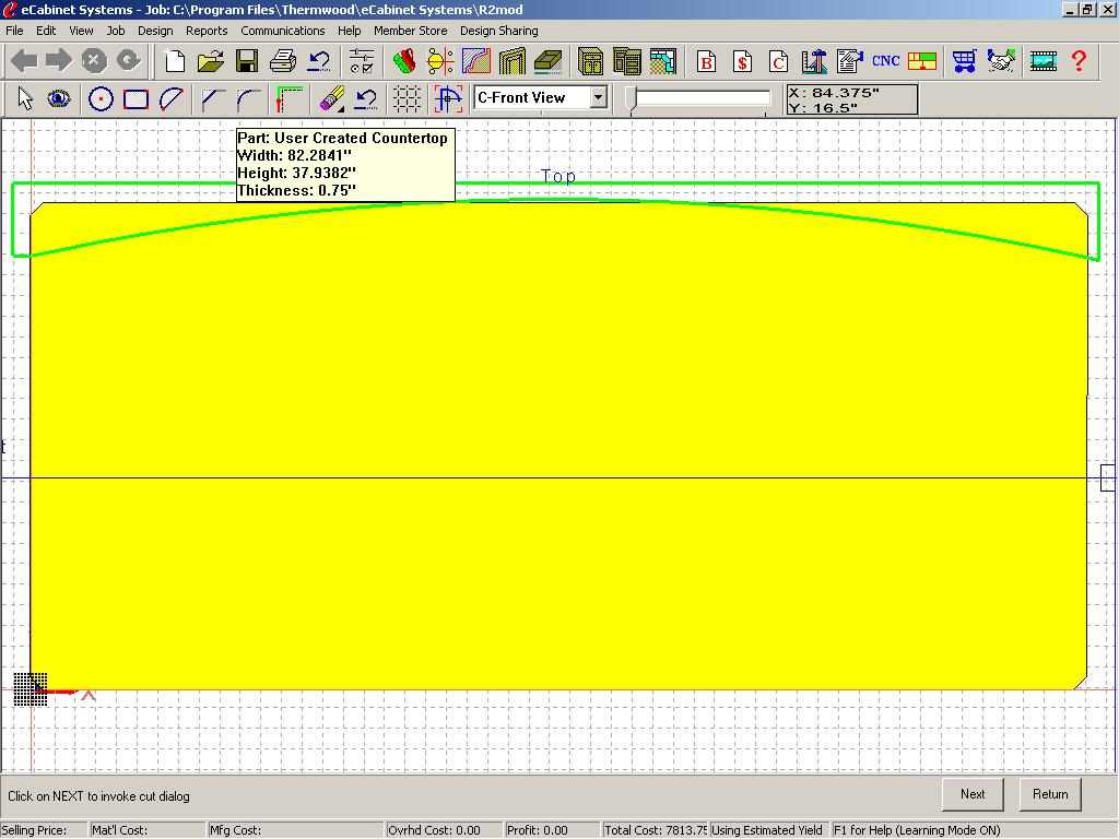

Robert -- Here are a couple of pics to get you started but you really should do some of the training lessons to perform these properly. When in Part Editor you have to toggle between Contour mode and back. Then you can pick a 3 point arc and then connect a closed contour.

I do it a slightly different way. Bring the countertop into the parts editor, go to the contour mode, right click and choose create edges. Make a curve using the three point arc on the edge you need curved. Then using the erase command on 'single' erase the straight line that was over written by the arc. Then using the trim command in two line mode connect the corners of the arc and the adjacent lines. Go back to the parts editor and right click the mouse and choose 'make part using closed contour', click on the contour lines and hit next. It should make your part.

Leo Graywacz wrote:I do it a slightly different way. Bring the countertop into the parts editor, go to the contour mode, right click and choose create edges. Make a curve using the three point arc on the edge you need curved. Then using the erase command on 'single' erase the straight line that was over written by the arc. Then using the trim command in two line mode connect the corners of the arc and the adjacent lines. Go back to the parts editor and right click the mouse and choose 'make part using closed contour', click on the contour lines and hit next. It should make your part.
I tried it your way Leo and after about 8 tries and going to the learning guide to see how to properly trim lines I got it. There is always more than one way to do things and I guess it comes down to how you learn to do it first. I think my way goes back a couple of versions. I will try it your way from now on. Thanks.
