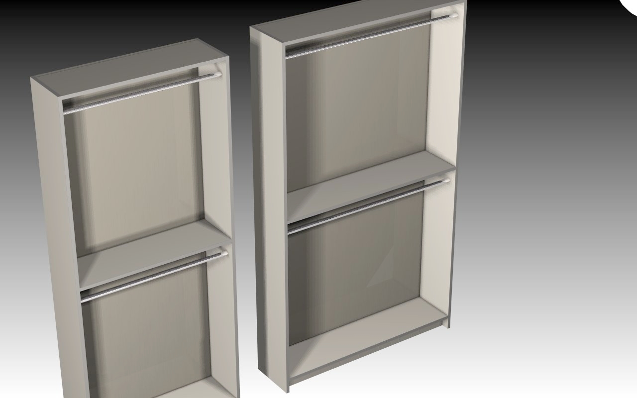

You can use a shelf made from a material called Closet Rod and give it the appropriate front and back insets, then take the shelves to the part editor and make them round. (see picture below) They will then re-size to width but you would have to change the back inset if you re-size the depth. I find it much easier to scale the display objects.
As far as I know there is no way to automatically re-size display parts.
