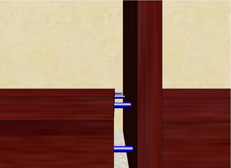

Hi Todd
Here is a pic of what I am talking about.
I tried unchecking visibility/ hole patterns but the space between the cabinets is still there. In other words, when I detail a room there is a gap that represents the KD pins. This does not happen when I use butt construction.
Bob
Bob
- Attachments
- RafixProb.jpg (64.58 KiB) Viewed 10243 times
Todd Miller
Bob,
It looks like you are just hiding the endpanel. We need to remove the end panel to get the effect you are looking for.
First, double-click the cabinet you would like to edit.
Next, click the constructions setting icon. This will take you into your construction settings.
choose, the right end tab
Next, uncheck the box that says \"has right end\"
This should take the gap away.
Note: This will add the thickness dimension of your endpanel to your top,back,deck,and toekick. So double check the width of your cabinet, and make sure it is correct.

Todd,
I just noticed that if you place his cabinet with no right end in overhead view on the right side of a room and add cabinets to the left it works but if you start on the left side and add cabinets to the right you get the problem with cabinets not snapping together.

Paul,
I am building my catalog of different closet cabinets.
I may be wrong but I was thinking its best to build a catalog and work from that when doing designs for customers. Playing with the software seemed to back that up. But I am really new to this and need all the advice I can get.
Kerry solved the problem. When placing \"open sided\" cabinets you must place the open end on the cabinet with the side on it. Simply reversing the direction I added the cabs cleared it up!
Thanks for all who responded!
Bob
