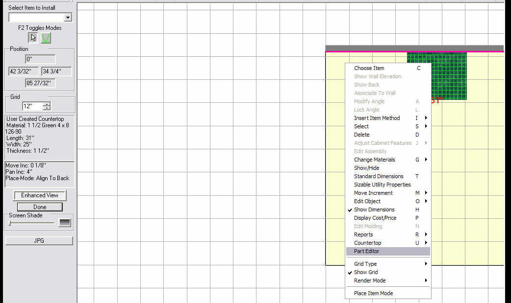

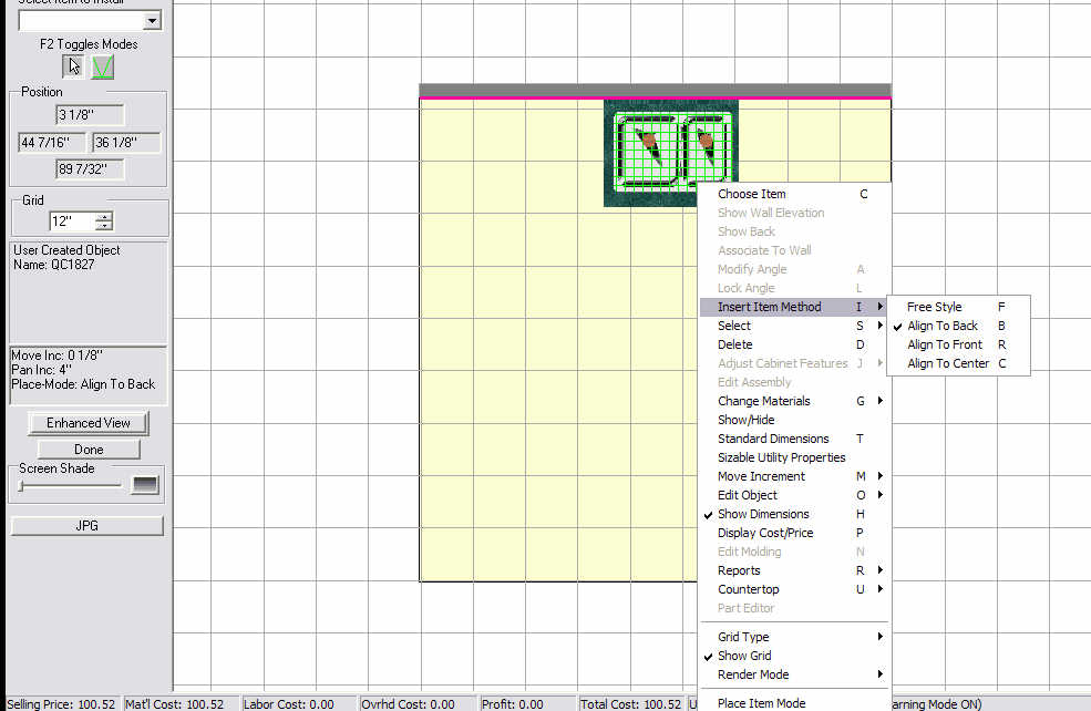

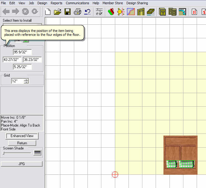

Hi Al, In detail room right click select choose item click display objects select the sink your after select click OK, the sink will be at floor level in your room. Hold shift, right click move to where you like then associate to wall bring up wall elevation and move into position. You can also use your position inputs on the left of the screen. HTH
Rick is better with words I am not good with words so I put everything in pictures
4 ways to move the sink and did you cut out the sink opening from the counter top
