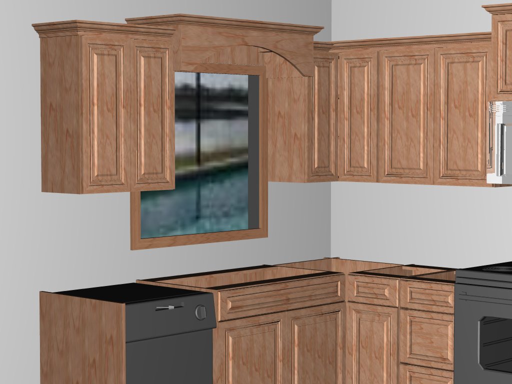

I did manage to install the microwave, but in presentation, as you can see, it doesn't look right.
Just after adding this JPG, I added a couple light fixtures. -that was the straw that broke the camels back... grey screen, nothing... end of the line. What's causing this? I'm at 2g RAM and 400g storage!

Kyle,
I would crop the original image the size you need for each window. It is obvious you don't need the entire picture so if you were to crop the original image maybe 2X the size of the window, this will help.
I believe you have an onboard graphics card, which from two years ago is a bit behind times. You may also try and update the graphics card driver.
Hope this helps...

Kyle,
I have attached a couple of microwave models if you want to use them. Unzip them and place them in your eCabinets/import folder in a directory where you can find them. You can scale these to size and you can take them to the Display Part Editor and right click on each part to change the textures and re-save them if you wish.
You might look in the eCabinets/Sample ,stl's folder also. There are microwave and other appliance parts that you can assemble in the Display part Editor. I think there is a microwave in the Sample HSF's folder also.
