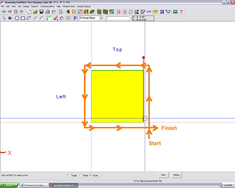

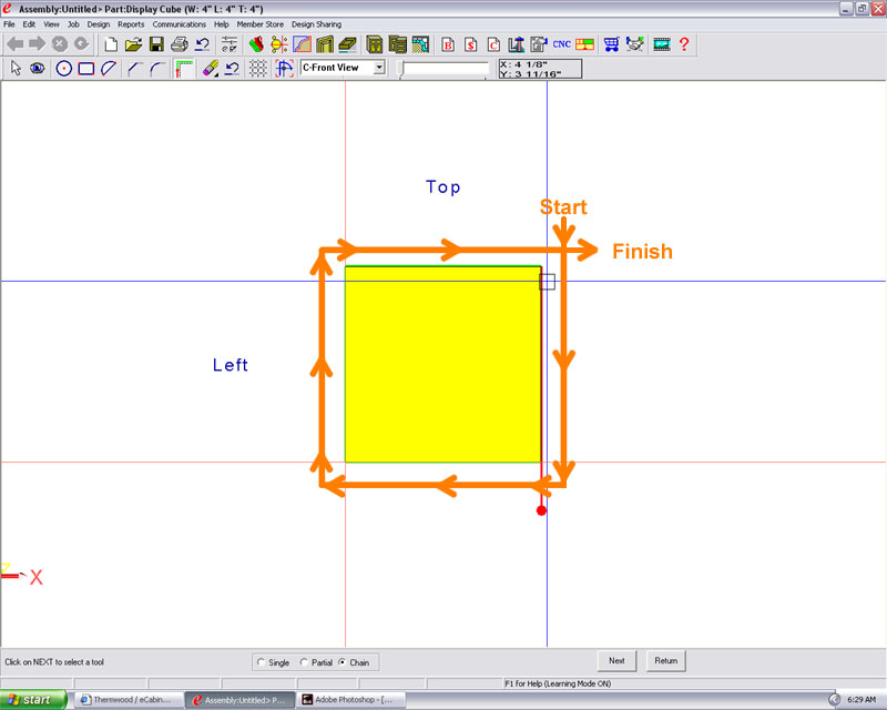

Paul,
Another thing to consider here is how you choose the 'cut path'. If you choose the right side of the cube pictured below, near the bottom right corner, the path will take you North, turn West, turn south, then turn East. The little red ball at the end of the line is your direction indicator, it appears at the opposite end of the path you choose. When you choose a 'chain' or 'partial chain' it shows the first edge that will be profiled in red, then the rest in green. If the tool you choose is only 1 sided and the profile you want is in the lower left quadrant like the tool I've shown below, then the selection that I show here would be correct.
If you select the path as I show in the 3rd picture below without changing the offset, it won't cut at all as no part of the tool is in the lower right quadrant. You can profile either left (blue quadrant) or right (yellow quadrant) depending on which way you select your path. Also, any part of a tool that is in the gray area will be above the piece you are trying to profile, and won't cut either.
I try to visualize the tool as a router bit on a handheld router, and then select my path as if I'm going to push the router along the correct edge.
