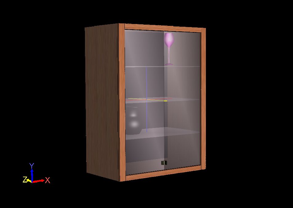

Hi Nick,
I just want to be able to easily add glass shelves and doors to cabinets that will resize. It's nice to be able to see through them as well. I've attached a rendering of what I'm talking about.
Joe
Nick M Singer
Posts: 828
Location: South Africa
Post by Nick M Singer »
Ok then add a sheet stock item called \"glass\" and attach the image you have used in your example.

Nick,
If you do that, the material comes out Opaque instead of transparent. The eCab guys would have to do some tweaking to get a transparent material.
