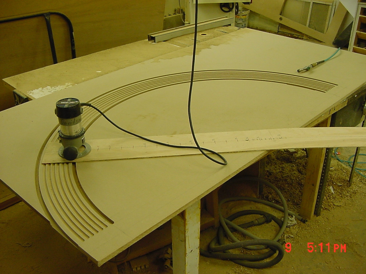

Here is my swing router setup I would like to get a nice one.
I did use masonite for my templates but now that my son's do a lot of
concrete they take my masonite :cry: So I use cardborad from all the builders.We do about 18 builders there trim and kitchen and concrete work
I keep there kitchen pantry and sliding glass door cardborad I have a rack in the shop just for cardborad.(Plywood I can not pick up any more)
I am 29 now I will be 30 :?: June 20 That is all right my son's are 34 and 39 they said they would help me. I slide the plywood around on the floor in the shop.
