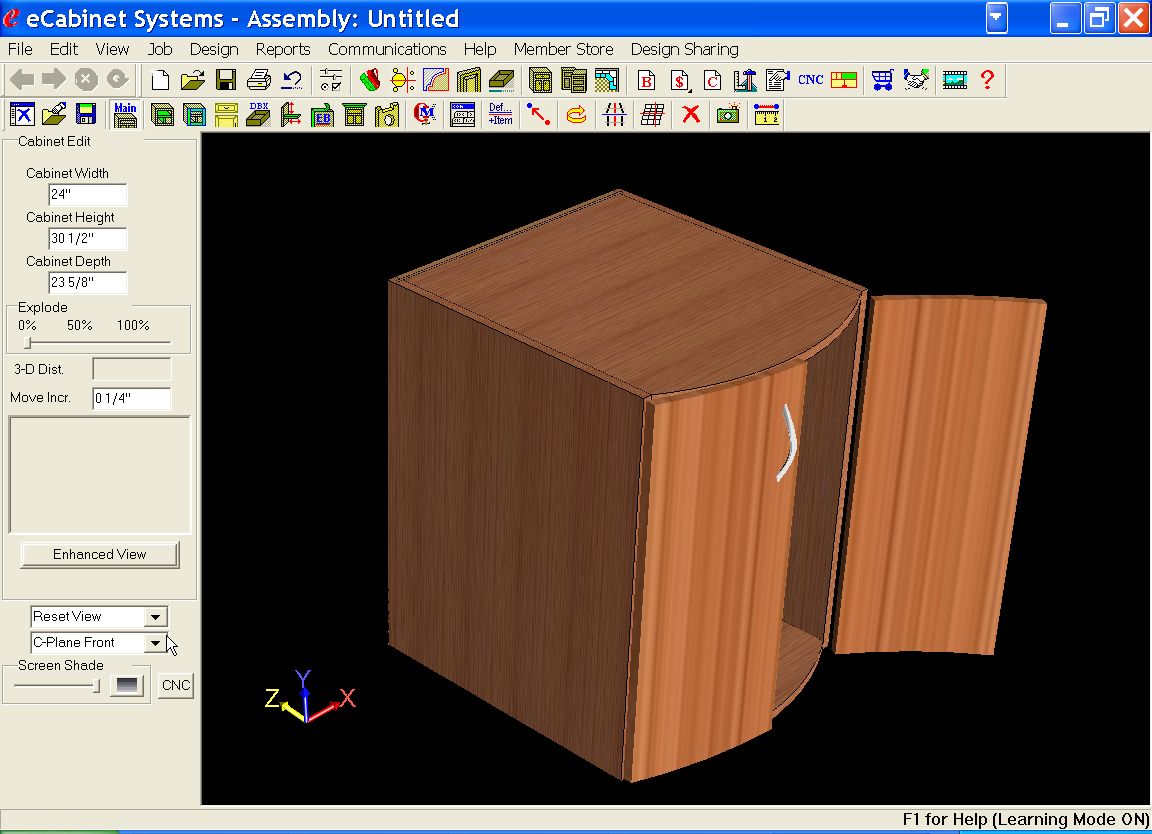

Something like this? It can't be done.
Joe

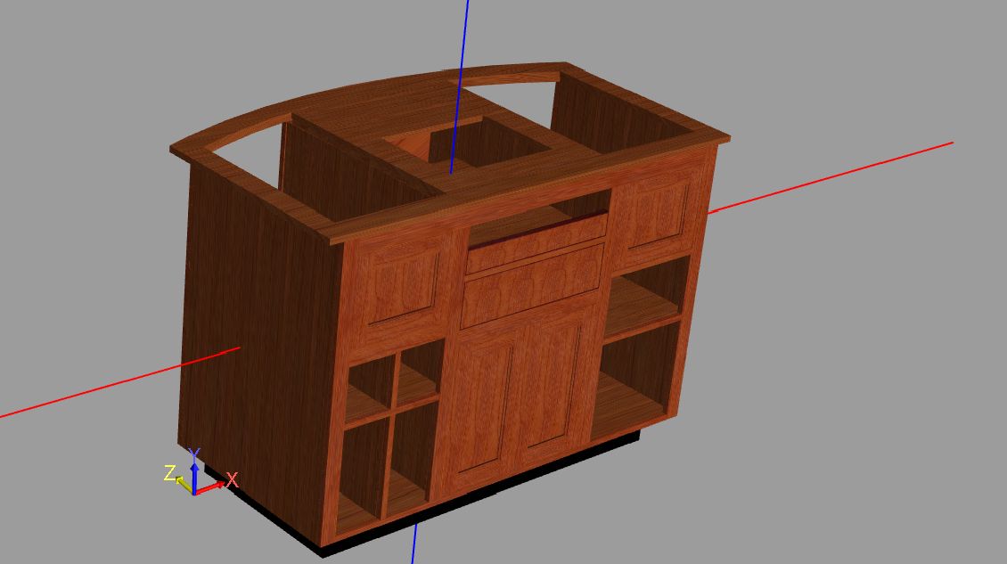

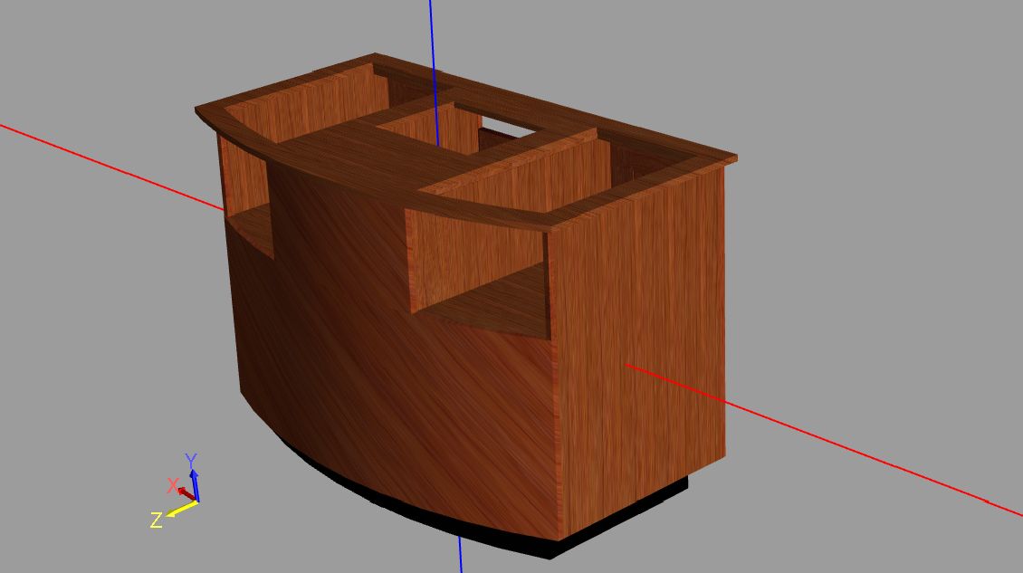

Hey John
Here are a couple pics of a curved front cabinet I started but never finished because the client decided they didn't want to pay for the curved work. This was to be a sales counter. As stated, it can be done, but you'll have to do a lot of part editor work, and use a lot of display cubes especially if you're using curved face frames. I started with a standard cabinet to get my layout of shelves and partitions, then took each part of the cabinet, deck, top, partitions, shelves to the part editor and cut the radius. It will take some time, but you definitely can do it. I never could get the grain direction right on the front. It always came out skewed after i made my cut.
Mike
