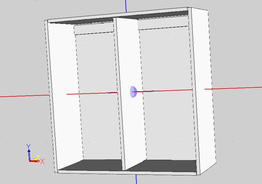

You could use a partition Bob.
- Attachments
- Bob.jpg (40.71 KiB) Viewed 4467 times
- Bob.hsf
- (176.02 KiB) Downloaded 484 times
