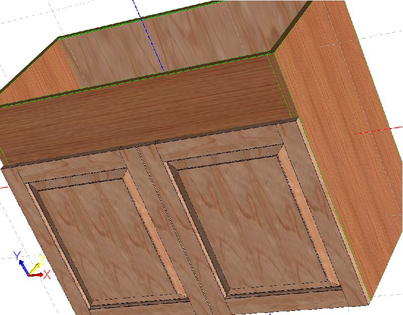

My vanity sinkbase design has a big broad stretcher across the front, on which we will fix the drawerfronts.
The problem is that the software needs an \"opening\" in which to orient a drawerfront, and there's none here. Thus the need to import (\"Load\") in a drawerfront and place it with the alignment tools. And then that drawerfront is not parametrically tied to an opening, so it cannot resize if the cab gets stretched or shrunk.
Got a workaround?

You liked my sink base design I see... You do not have to add a drawer front. The software will not recognize the strecher in the door/drawer editor. Notice when you light up the opening it will show the whole opening like there was not a strecher there. manually adjust your door height to whatever you want it to be,make sure it laps the strecher by at least a 1/4\", the strecher is also the door stop. you can then light the opening up again and add the drawer front. You can also do it just the opposite add the drawer front, with top reveal you want, manually set it to the width you want, and set to adjust bottom, then add your door. It will all resize correctly in width, as with many cabinet designs though, you have to be careful with changing heights, I have one designed for each height I need.

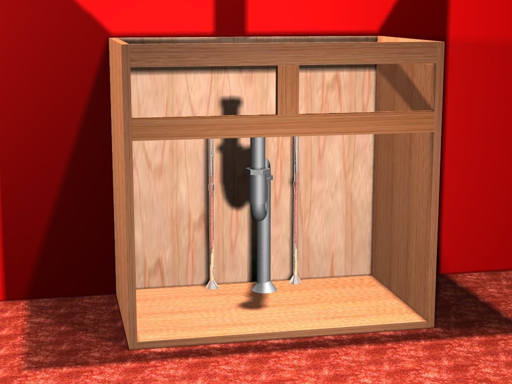

Try this cabinet. I used a 1/16\" thick sheet stock called divider (that you will not cut) to make a fixed shelf and partition using butt construction to define the opening. You will probably have to adjust your drawer reveals.
gene.zip
(157.62 KiB) Downloaded 516 times
This will work also Gene, just delete the drawers and disregard the partition in your cut list.

Here is my sink cab.
There is 4 doors and it can be resized
The center is a shelf and partition (I reset my sheet stock)
Then I use pocket holes

Since I had set my mind on the big broad stretcher oriented up-down across the front, I chose the method suggested whereby a divider shelf and partition, made of some 1/8 stock I created and called \"1/8 divider\" were placed to define the two openings for drawers.
What I found interesting, is how the software has a problem doing the shelf and partition work, if the front up-down stretcher is already created. The stretcher, if in place, blocks the upper opening, so I cannot place the partition. So, I deleted my stretcher, placed the partitions, then did the stretcher placement again.
Everything works as desired.
